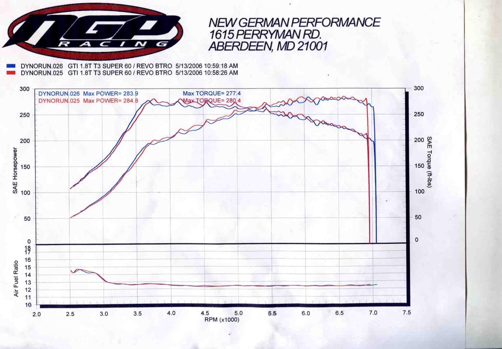

old T3-Super60 dyno (100 octane)
- REVO BT software
- 440cc injectors
- 3" exhaust
- GReddy FMIC (T31)
319 whp / 307 wtq
- REVO BT software
- 440cc injectors
- 3" exhaust
- GReddy FMIC (T31)
319 whp / 307 wtq

Here is one of my T3-60trim dynos:
Here is one of my K03 dynos:
Both done in 3rd gear and on a dyno jet. Notice the difference in lag? The K03 got full boost by about ~3400rpm and the T3 by ~3600rpm. Not much of a difference at all... this is on a dyno where there is less load than on the road...in the road they will both spool considerably sooner. But what is the difference? 200-300rpm? That's is almost negligible and you honestly can barely even feel the difference in time.
I cannot think of a single person who would find the T3S60 laggier than a K03s...especially after feeling the HUGE difference it make in power. 50+whp difference is pretty hard to ignore.
And this is from someone who has actually OWNED both.
