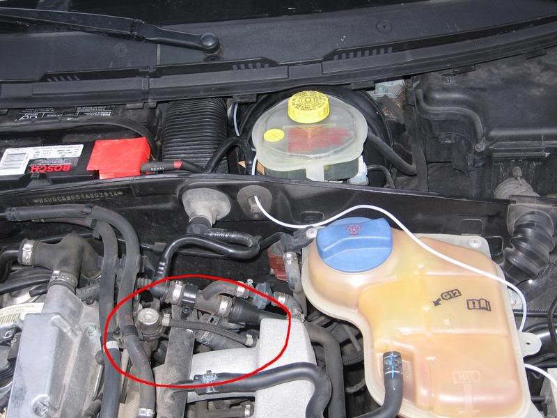

do you mean this one?

ORIGINAL: turbo kraut
No...it runs directly beneath the hose at the bottom that says 15/00 (bad eyes)... and connects directly next to the orange tube.

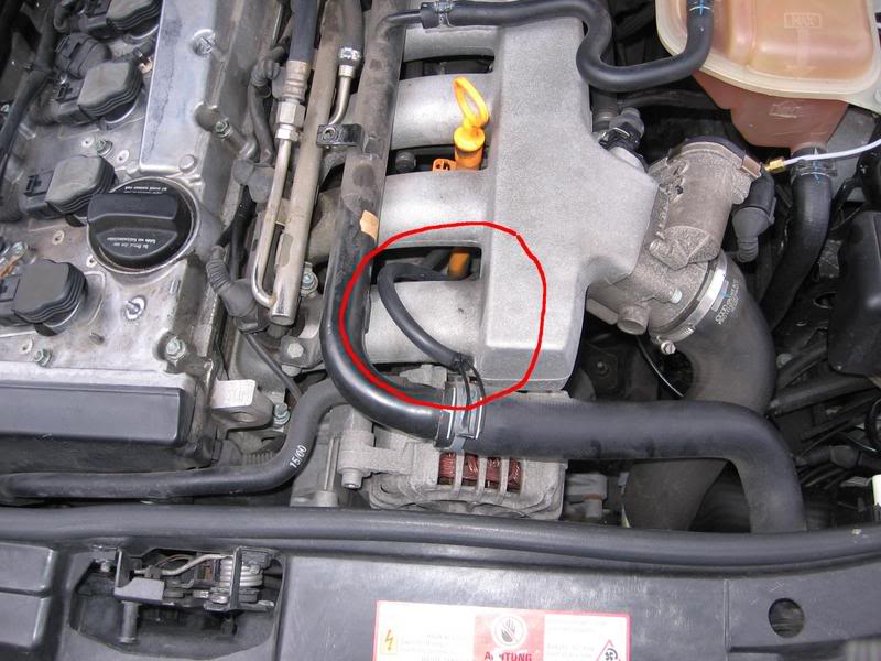

that is as close to the dipstick as you are going to get unless it is the one on the fpr
