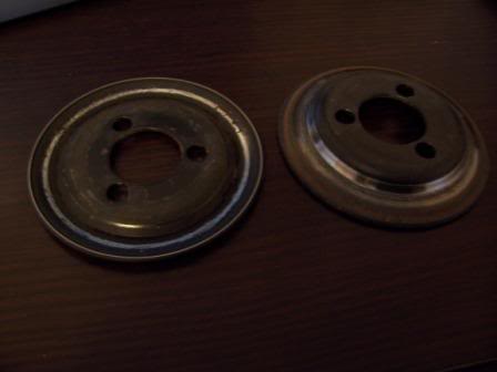

Ok, I started taking apart the front of my A4 last night to start the WP and timing belt job at ~157K miles. After getting the radiator and viscous fan out of the way, I notice the WP belt is clearly much too loose. How did this happen? I started looking for adjustments on the powersteering pump to see if there was a bracket to adjust/tighten it, which may have come loose? There is no such adjustment...the WP Pulley comes apart,and when the two halves are put back together, the belt that drives the WPbecomes tightened in there. The belt is so loose that I can't hold it to take off the 3 socket head screws that hold the 2 halves of the pulley together. I was able to get a grip on the back part of the WP shaft backing plate with some Channellocks and loosen the 3 bolts.
Then it all becomes clear....the back half of the pulley was on backwards!!! It caused the wpbelt to slip like crazy for the last 70K+ miles!!! The belt wasn't tight enough to even spin the wp under load, and I bet it wasn't even pumping at least 95% of the time.
I gotthe WP andtiming beltdone last time at ~85K miles at the dealer -Valenti Auto- Watertown, CT, where I bought the car. So for $1300. So it's 11:55 AM - the dealer closes at 12. I call them immediately and tell the service advisor, Brett, to not go anywhere and I'll be down there in 3 minutes. I showed him and this other guy, Bob the pulleys and the worn, cracked WP belt. I showed him how there was rust on the part of the back pulley that was facing the engine instead of making contact with the belt, as it should.
I am dumbfounded: 1. That the engine is still going with the belt like this for 70K miles.

Here's some pics for you all to enjoy....that I will also be sending to Audi of America.

I remember noticing once or twice a few months back that it was loose, but it never caused coolant overheating, and the engine oil temp was always around 225*F, which I figured was just normal. I don't remember what the oil temp is supposed to be at, since it was up at 225*F for the last 70,000+ miles. If it is supposed to run cooler, someone let me know, because this may have caused some problems that I'm still unaware of.

Well the normal operating temp is around 225 F, and un-fortunately the part never really failed due to poor workmanship. So this is how its gonna boil down, the dealer is liable for the problem, not the parts, and not audi of north america. You're gonna have to go to battle with this dealer to get all if not some of your money back. You CAN contact AOA about it but they aren't gonna compensate you for the money, they can add additionalpressure to the dealer to pay you your money back however.
As for your engine it should be just fine, most of the time when i have to do water pumps on old 1.8T's the belt is loose like that too, because the water pump bearing is just worn out.

Thanks, at least I can be pretty sure now that there was no real engine damage from the engine running too hot consistently.Andthe water pump bearing still feels brand new... I'm thinking because it never really had any load on it, and the belt was never tight enough to keep the pulley turning at high rpms. It's heat and load that wears out a bearing, and this bearing most likely saw neither. Regardless,I already installed the new water pump.Any advice from anyone else on how to go about getting compensated by the dealer?
