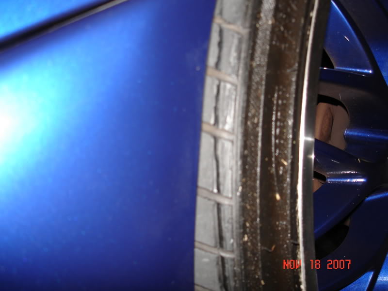

Chachi717 Nov 18, 2007 11:10 AM
RE: wheels scraping
5 Attachment(s)
ok well my wheels are 135/35/19 and the offset is 8. here are pics of how low i am and some of my chunks missing, the pics arent that good so i apologize.

MissingLink Nov 18, 2007 11:28 AM
RE: wheels scraping
im pretty sure that offset is wrong it should be like 35 best place to check is audiworldforums.com or tirerack.com do not know for 19s
Chachi717 Nov 18, 2007 11:34 AM
RE: wheels scraping
my bad guys when i said my wheel size i meant to say 235/35/19
MissingLink Nov 18, 2007 11:44 AM
RE: wheels scraping
what i ment by 35 is the wheel offset . not the tire it should be between 32 thru 40 offset im pretty sure the tire size is right you cant really go lower .and those rims look like the offset is wrong ther sticking out a bit in the front
