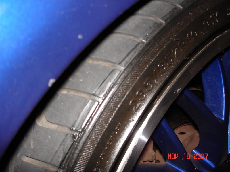

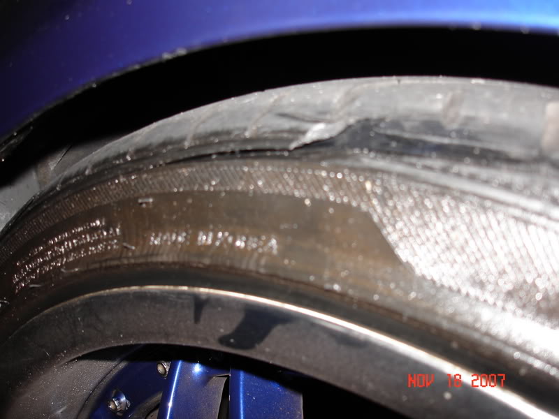

ok well my wheels are 135/35/19 and the offset is 8. here are pics of how low i am and some of my chunks missing, the pics arent that good so i apologize.

im pretty sure that offset is wrong it should be like 35 best place to check is audiworldforums.com or tirerack.com do not know for 19s

my bad guys when i said my wheel size i meant to say 235/35/19

what i ment by 35 is the wheel offset . not the tire it should be between 32 thru 40 offset im pretty sure the tire size is right you cant really go lower .and those rims look like the offset is wrong ther sticking out a bit in the front
