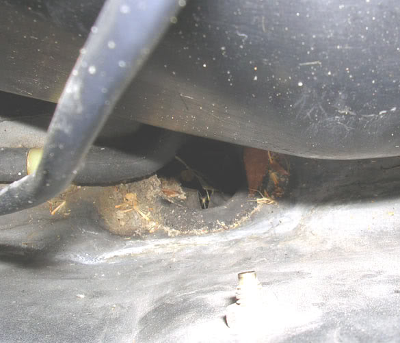

Here are a few pics I just snapped for you, to have an idea what you're looking for even though are different models:

The drain under the battery box was wide open. It rained so hard the only thing I can think of is that the water made it under the cover some how and leaked into the cabin air filter.
Well I dried it out and have it smelling nice again. I put some tape over the cover seam and I'll see how that does.
