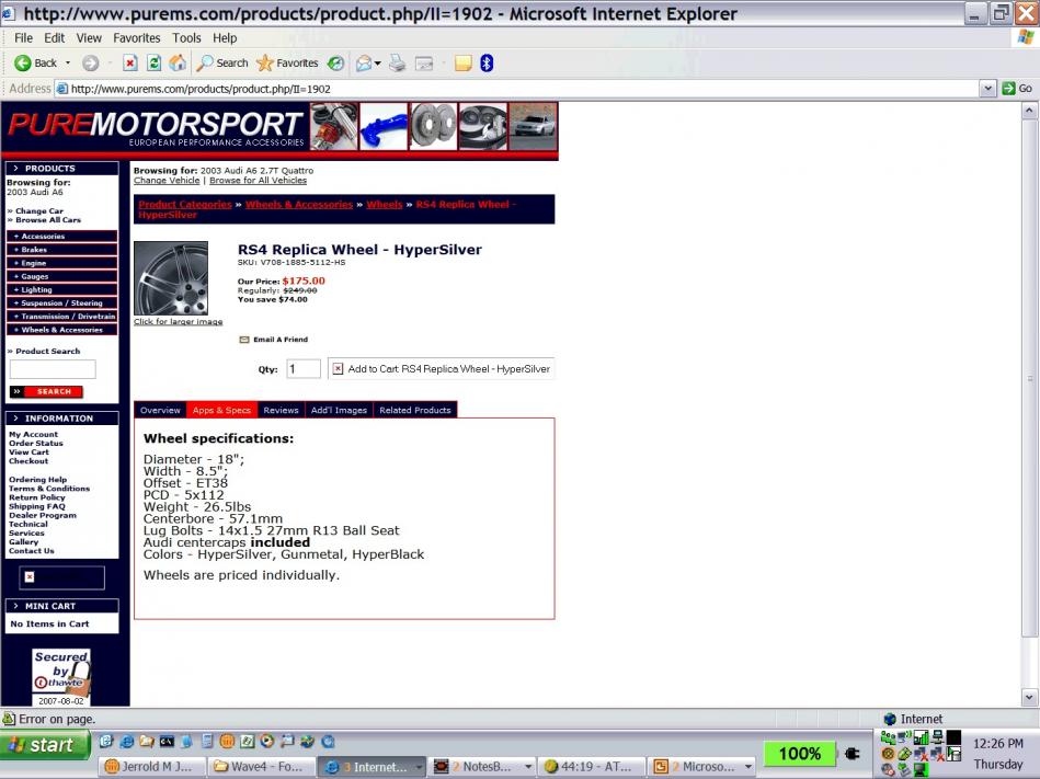

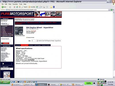

I picked up RS4 replicas from www.purems.com and they fit fine. Offset was ET38 and they were 8.5 x 18".
I've bought quite a lot from Pure Motorsports. Great vendor! The wheels are from www.velocitymotoring.com
Attached Thumbnails 18" wheels for A6 2.7t PLEASE HELP!!!-audi-velocity-rs4-rims.jpg
