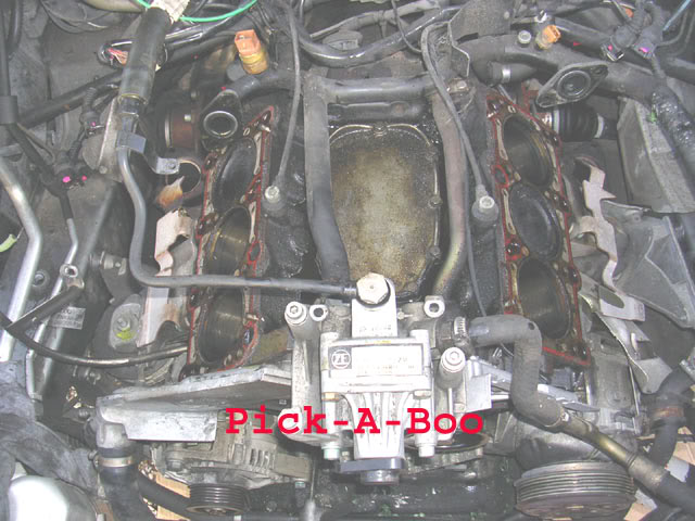

You should be able to see it on the pipe, right next to the 2-prong coolant sensor. There's a "jungle of wires and wire connectors there (the coolant pipe has a support bracket on it there for a couple of connectors), but you should be able to see it.
It is like a 6-8 Allen head little plug-bolt. (EGR Valve area - so rear of the driver side bank)
You can see it here:
or here (top right in the pic):
Please disregard the "text" on the pics...LOL

After I finished the work I did on the motor a couple of months back (including TB,WP, T-stat, head gaskets, etc), and refilling with coolant, I didn't bleed it properly. I only bleed it at the heater hoses, behind the firewall. I couldn't really get to the main pipe bleeder , because I didn't have the proper reach (Allen wrench or socket bit). Well, as it was getting hot, the fluid was bubbling in the expansion tank and was reaching the top of the tank; the engine side was HOT as hell, while all the front hoses were COLD. I knew that there's no proper circulation.
What I did was to empty again the system, start all over again and remove/eliminate that support braket on the main rear pipe and just re-route or leave those 2 connectors it holds suspended. That gave me full acces to the bleeder, with a socket bit and extension. Emptying again the system was a good occasion to flush it again with water, a couple more times thoroughly. I even flushed the heater core (pouring water through the feeding hose, and have the return loose into a bucket).
After bleeding in the proper sequence (at the heater core first, then at the rear main pipe), I got lots of air coming out at the main pipe bleeder. It was like the geysers at Yellowstone...LOL. After I got a steady flow of coolant, I tightened it up and shortly after the T-stat opened up and the coolant started flowing throughout the whole system as it should, and the fans kicked in.
If I were you, I would try to rebleed the system first. If that fails and you still overheat, then probably you should look into the water pump, if you get that metallic or strange noise.
