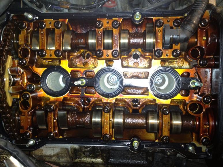

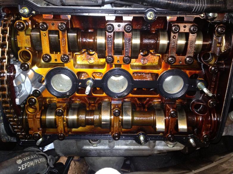

So I pulled the valve covers back off and set crank to TDC. Bank 1 marks are lined up perfect and the tensioner (original with replaced pads) is sitting up above the 2 metal prongs (guides).

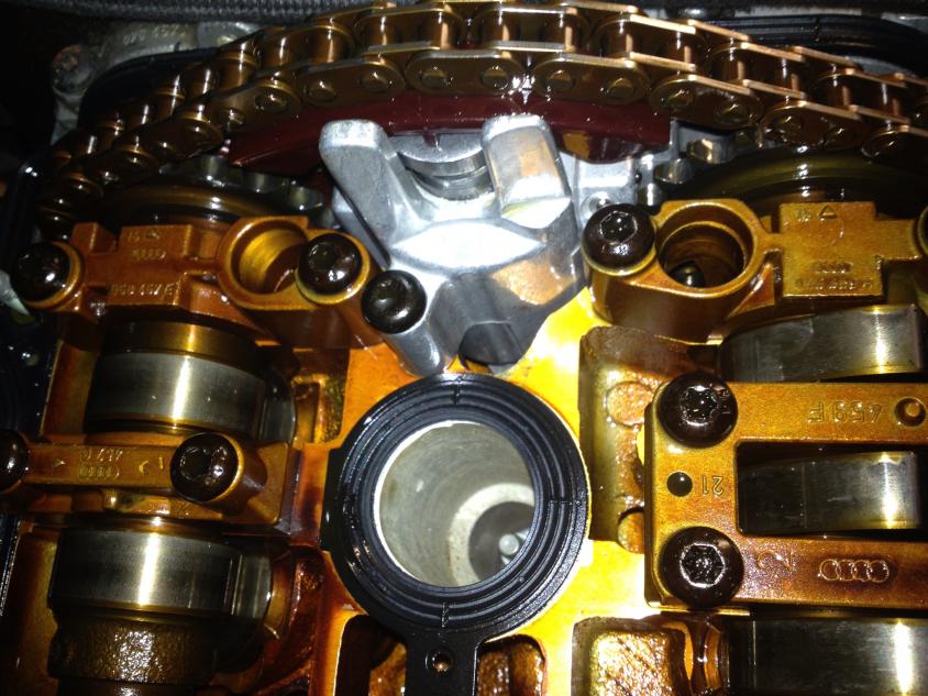

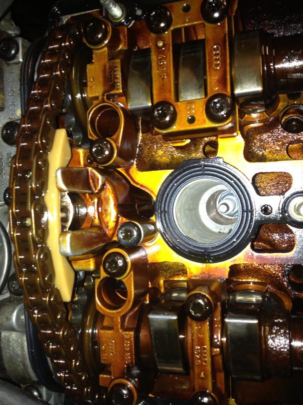

Bank 2 (drivers) the exhaust cam is lined up perfect, but the intake notch is about 4mm to the left (toward intake manifold) of the arrow on the cam cap. I also notice the new tensioner I put in is sitting low. Well below the 2 prongs.
This must be my last issue. But I don't know what to do about it. I am sure if the chain was sitting at the proper height the intake mark would be on the money. Could I have done something wrong installing the tensioner? Do you have to prime a tensioner?
When I thought the engine was toast I put rotella T 40 weight in the motor, would that cause this? I was planning to swap back out to synthetic when done...
Thanks for any help!!!!
EDIT: So I went back out put tensioner tool in Cam tensioner with oil sprayed on the main shaft. It appeared to be dry compared to bank 1. After moving tensioner up and down a couple times with tensioner tool... It now seems to behave like bank 1 tensioner while rotating crank.... They both bounce up and down when I try and turn crank... That being said it still appears the new one I put in the main shaft that goes up and down doesn't get any oil on it.... If I look at bank one it is well coated with oil....
As it sits now timing looks pretty good... exhaust cam lined up perfect, and depending on how the tensioner sits when i rotate crank, intake notch varies from being right on the edge of the triangle mark to 4mm off the mark. The only thing I can think of is to rotate intake cam back 1 tooth so I get closer to 14.5 roller links?????

I hooked up the vacuum gauge again and now I am up to 14in vac at intake manifold. Green is 15-20. If I bump throttle to 950 rpm I am at 17in and smooth as silk. Note: the needle is very smooth on the gauge, no bouncing.

I shared this with another guy long time ago.
I know that some cases the cam mark doesn't line up with the peak of the gear tooth.
Anyways, you mentioned that it is 4 mm off. 4 mm off to the intake side or the exhaust size?
the intake cam is off 4mm towards the intake manifold.
What did you mean by go off the cam marks not the triangles? I thought the cam notches needed to line up with the triangles on the cam caps.
I have 3 of 4 cams lines up dead nuts. just the intake cam is a bit off. It was off the same way when I took it apart initially, but i attributed that to the top cam tensioner pad was gone.
Once the exhaust cams are lined up by the lock bar, your intake cams can vary in their positions a bit based on the tensioner position. Once the exhaust cams are lined up, then count the lobe between the cam notches, not the triangles on the cam caps.
