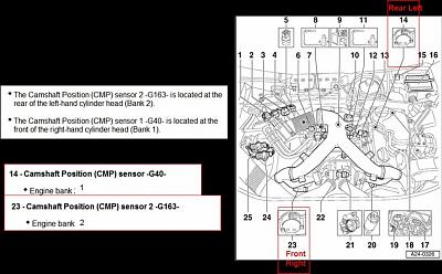

You have 2 Cam Position Sensors (CPS); one for each bank. Driver's side @ rear, Passenger's side @ front.

No head removal needed. For G40, you may need to remove the Y pipe to get better access. G163 required removal of adjacent coolant line & sensor to get it off. Both are located just below the valve cover edge (in line with the camshafts). Did they tell you which CPS was bad, so you know which one to mess with? There are some resistance &/or voltage tests IIRC to check CPS. Removal of CPS is 2 bolts & 1 connector. Pretty easy, once you can get to them.

DS is G163. Ignore the 14 & 23 numbering in my prior pic. It was a copy from the manual & it's a typo. G163 is DS rear. The pic of CPS from ECS is the part.
