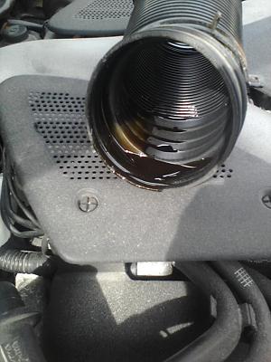

I appreciate the response; i finally decided to look at the air intake; and took the plastic piece that connects the Y shaped to the MAF; to find it full of oil; the second i took it out oil was pouring out of it; anyone knows what this means?

if the PCV valve goes oil start to come out of the exhaust?; I mean the car almost lost all oil in the engine; and the back window of the car when you pass your finger through it it is all oil; the same as the pumper cover. I had to add 5 qrts of oil back into the car; and it is still not at the level where it should be.

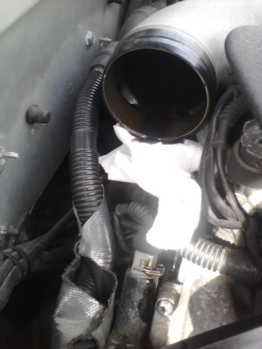

I finally was able to find where the PCV valve is located; I pulled that thing off and surely there was oil in it; I started the car with the valve not connected; and white smoke was coming out of it; well from the muffler there was alot more smoke coming out to be honest; but the smoke coming out of the PCV valve; does that signify anything.
Here is the Dillema I put myself in; I knew that the turbo was going out; but had no clue that the car would just start pouring oil out of the muffler and that I would loose about 7 quarts of oil in less than 10 minutes driving.
on any case; how do I know if I damaged the engine or not; I would hate to take the car and get the turbo s replaced to find that the engine is still smoking; any help here is greatly appreciated.
