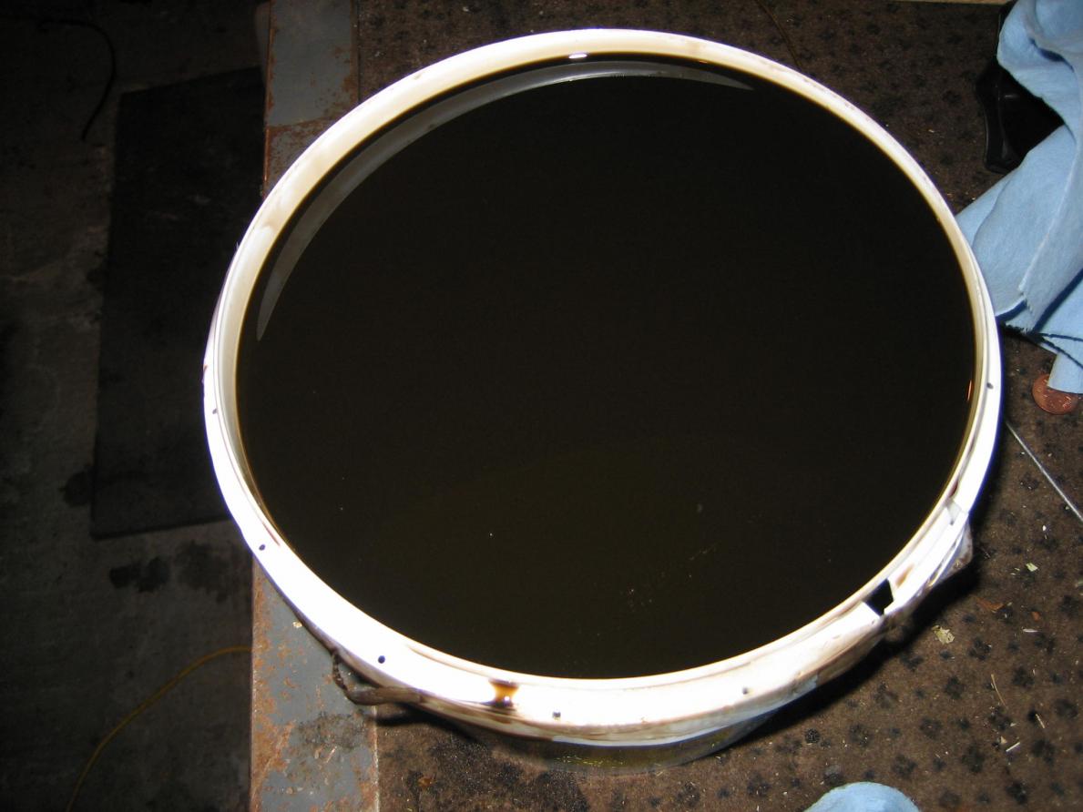

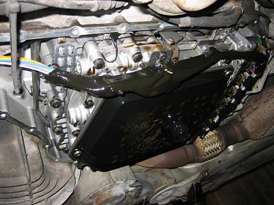

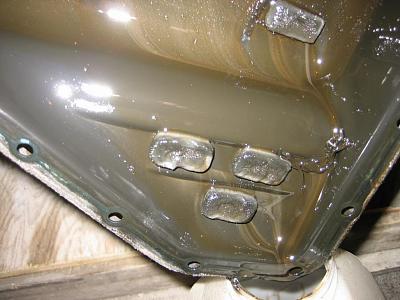

Well, the feared has been found. My 4.2 transmission is toast. First thing I did was topped off the trans fluid following the proper procedure and added nearly a full quart. Still the car has no forward gears, just reverse. So put it back up on stands, drained all the fluid and pulled the transmission oil pan. Despite the one quart of new fluid added the fluid was nearly black, the car has 95K miles. I'm pretty sure it's the original fluid. The Transmission filter says August 2000 on it, so i'm pretty sure it's all original.
There was no metal or broken parts in the pan, just a thick layer of sludge on the magnets, see the pictures.
The issue that concerns me is that the plastic shelding that holds the Valve body wiring together was nearly melted off. This tells me that this transmission overheated severly.
