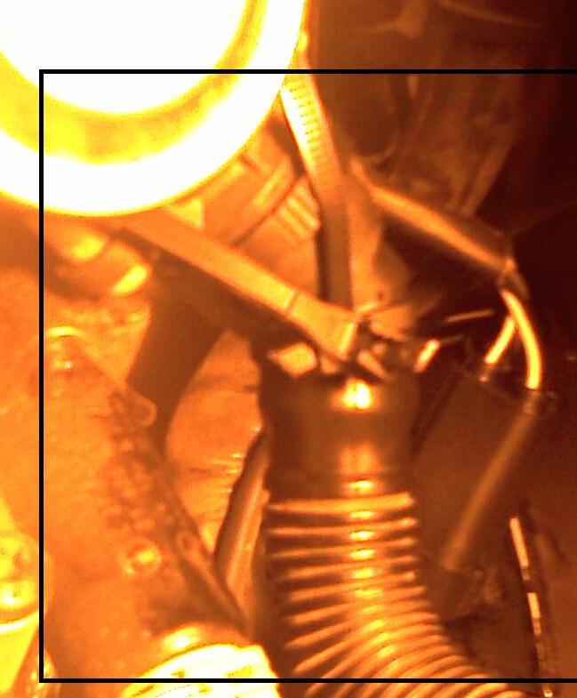

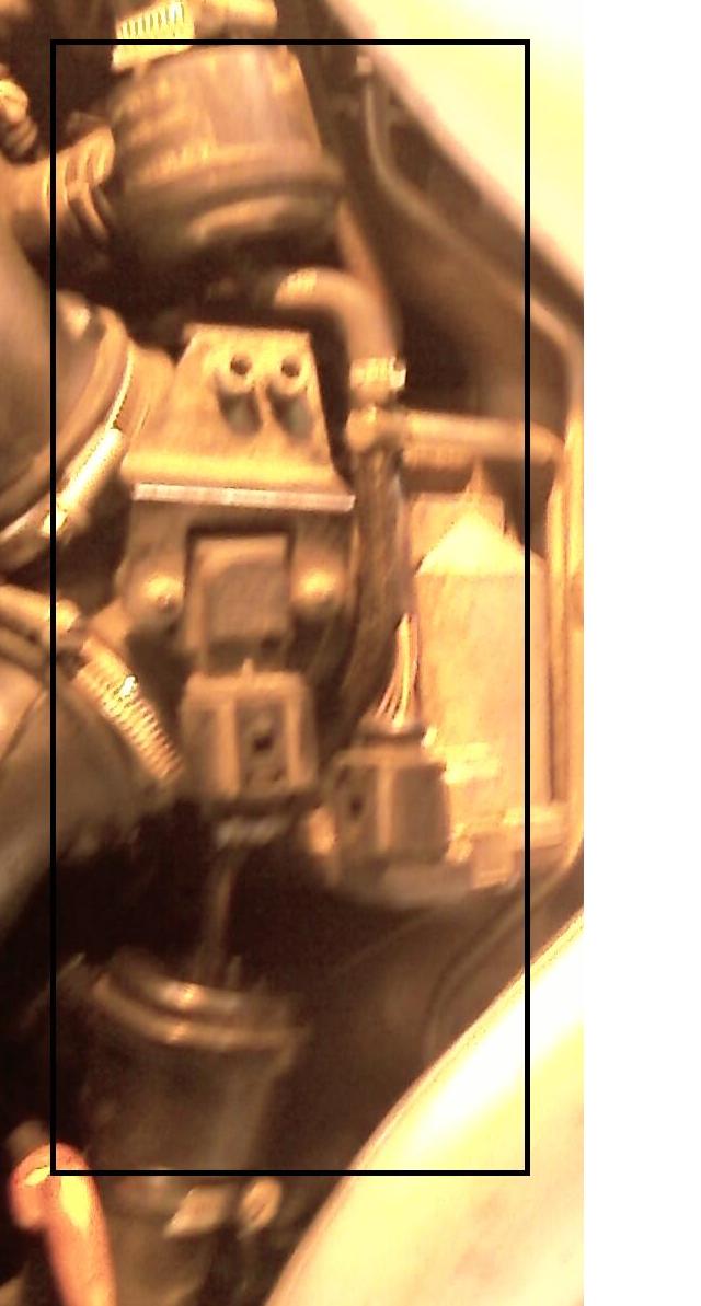

HXGASER - Thanks a lot for your Reply
I went back to my old Camry mechanic who was my friend.
He checked it and first thought that it due to an old cramped hose in pic 1.
Then he changed it with a new hose and cleared the P1423 code.
Today I got the CEL again. Took it to him and he checked some more and it seemed that the pipe in pic 2 was loose, So he put some straps and fixed it for now.
I dont know what that pipe is, Can you please let me know so that I will order it and get it fixed properly.
Once again, I am thankful to you and to this forum.

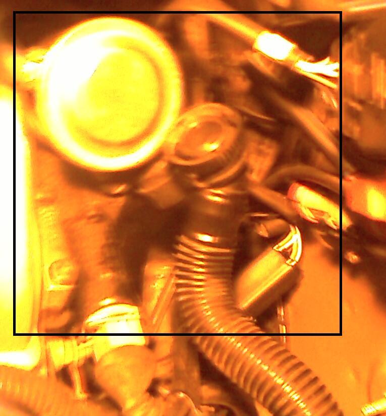

Sorry, I had only my cell phone when i went to the mechanic.
Now I am noticing that the mileage has come down drastically. I was getting around 20-22 mpg but now it came down to abt 15-17 mpg.
I am not sure why. Using Shell premium fuel since I bought it.
