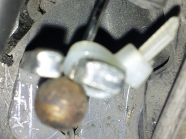

belated photos
I have performed numerous repairs since I promised to post photos.
Here they are of my repair and the surrounding area.
The red lines represent my hook. If they are dashed I tried to represent them as hidden or as seen from the backside. All-in-all it took me about 30-45 minutes to fish/grab and open the hood.
It required removing the front grille with the Audi emblem. Go slow. you WILL get it. You will set off the alarm. Have your keys handy to shut her off and good luck.
The blue thingy is a b-connector on the end of the wire. We use them in security (alarms, cameras, etc.)
