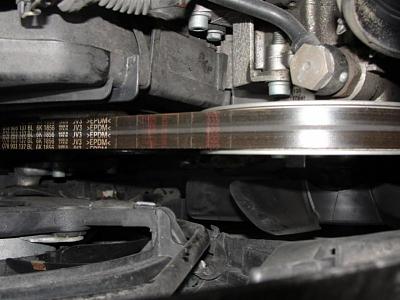

Start off by removing the weather stripping from the bumper and plastic engine covers that block access to the serpentine belt, see Serpentine in the car.JPG.

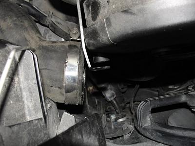

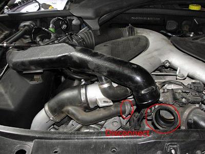

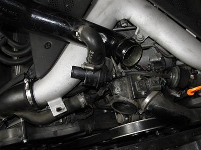

Next, remove the plastic vacuum line from the left side. Undo the clamps and remove the screw at the bottom of the plastic vacuum line as shown in the pictures below. Also, the plastic vacuum line sits on a lip near the bottom so it'll take some work to get it out. See the following photos.
Once the plastic hose is out of the way, you can now freely access the serpentine belt.

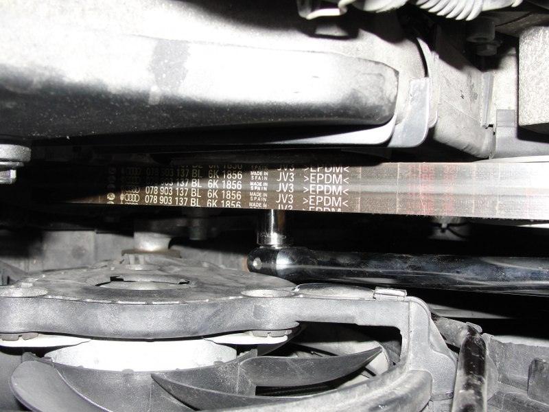

Get your 17MM Socket and Breaker bar and attach it to the nut and rotate it towards the driver side, see Belt Tension Bolt Location.JPG While holding presser on the breaker bar (relieving pressure on the tensioner), put the locking pin in (allen wrench), see Belt Tensioner Relief Pin Placement.JPG. Note, it's best to feel for the locking pin location first before getting the breaker bar in there.
Slide off the old belt.

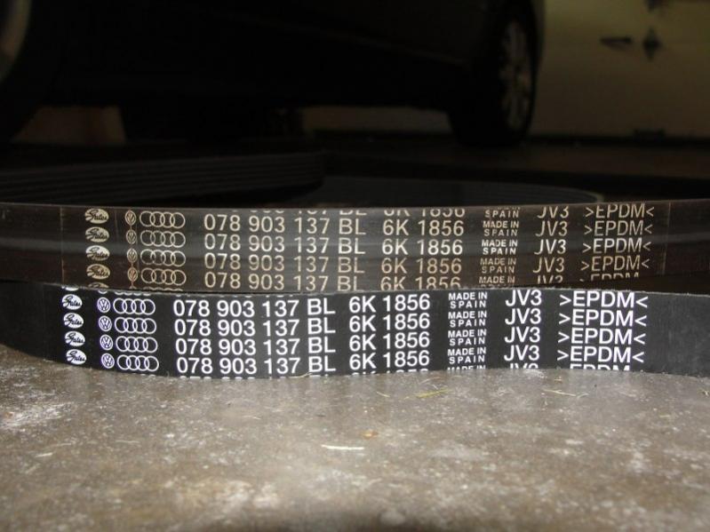

Compare the old belt to the new belt, see Old and New Belt.JPG. Their lengths should match!
