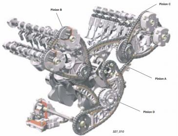

The problem with doing this repair yourself and the reason for the high cost of the repair is that the engine needs to come out to service the chains. There are 4 of them and they are all on the rear of the engine.
You mean to say that the car has a total of 8 chains (4 per head), or that the entire engine (2 chains per head) needs to come out?
If the later is the correct one, as I suspect, then why the entire engine needs to come out to only repair Bank 1?
Also, the fact that the chains are on the rear side of the engine should make no difference in the grand scheme of things since the head has to come out anyway, shouldn't it ? Thanks
