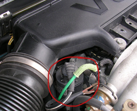

Thanks for all the tips, will definitely investigate. Where is the ICM located, (idle control module) I'd like to try chefro's suggestion. Is there someplace that shows like a schematic of under the hood? diagrams of where everything is? Not sure if they have that, but I am no where near a mechanic.
Kev, I don't have a diagram as I don't possess yet a Repair manual.
However, you need to look for something like this :
On my 1995 is right under the air intake tube, close to the engine block/head:
Attached Thumbnails 98 Audi A6, won't stay running, revs up and down-icm.jpg
