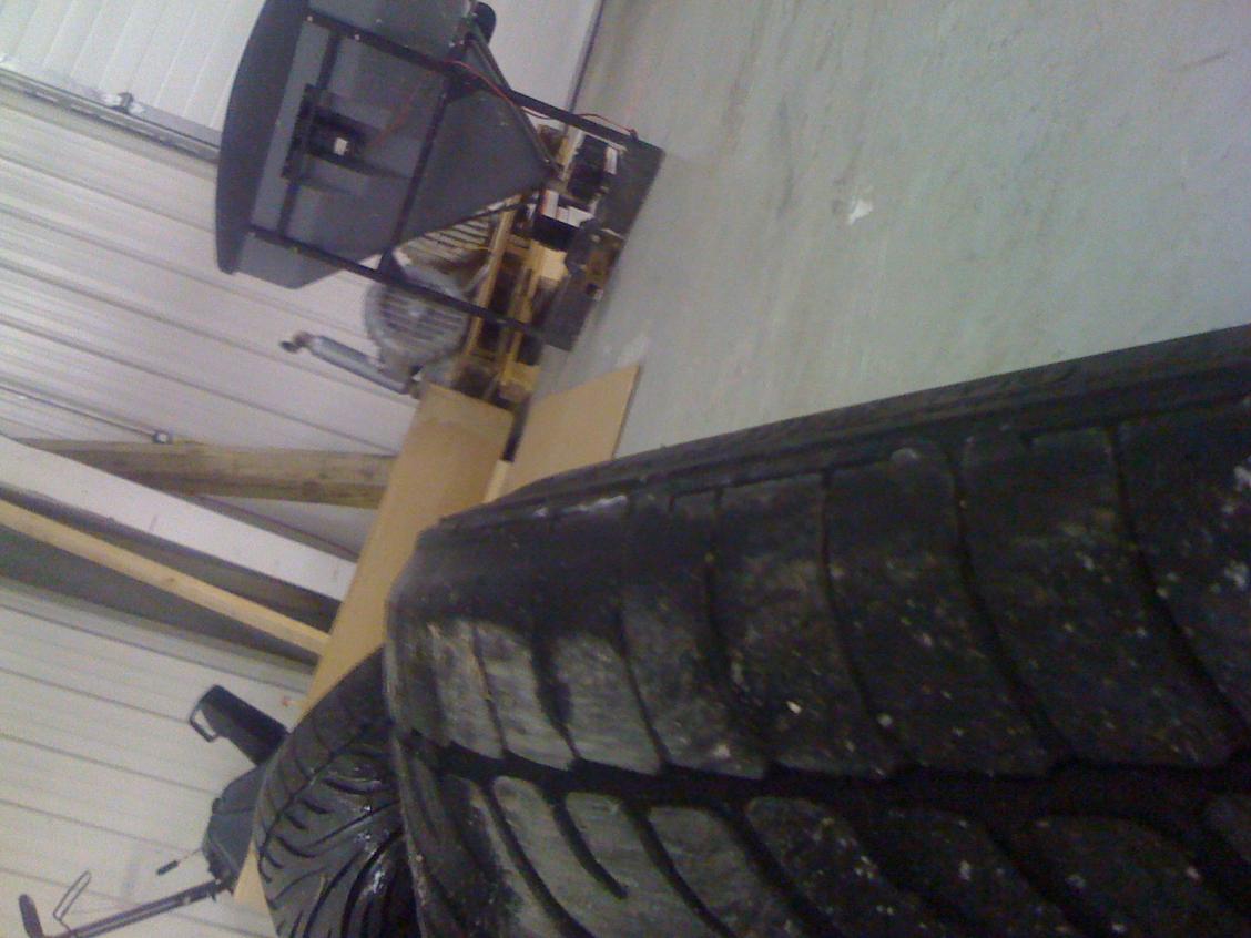

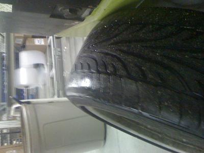

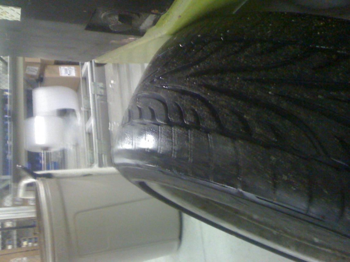

Anyone have corrected alignment specs for 2002 A6 2.7 with Koni FSD Eibach pro springs? Just received pro kit (2100-4044) from tire rack and don't want to change until i have correct alignment specs??
The alignment specs with the PRO springs are identical to stock. A little toe out and negative camber helps handling but will accelerate tire wear - on the inside edge - see picture above. On an A6, this type of wear indicates a bad tie rod end or control arm. I have had bad control arms that you could not see any movement whatsoever when forcing the tire around by hand. It was the bushing end that went bad, not the tie rod end. How long since you replaced at least the front lower rear control arms?
Bob
Bob
I haven't replaced any parts yet. I have only had the car for about a year. It started this summer with the original set of tires then i put a different set on and now the second set is doing the same thing. I have been trying to figure out what would cause this type of problem before just throwing parts at it. I's going into the alignment shop next week so hopefully i can get it all worked out soon. Thanks for the advice!
