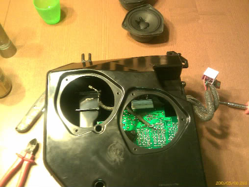

It was just 4 x M6 nuts (10mm socket) to get the unit out, two are obvious when you pull the vanity pannel off, the other two are holding the bracket and are behind the wire harness & squirter hose that are held in place with cable ties.
You'll need a T30 & T10 torx bit.
Whip out the 4" cones and remove the speaker wires.

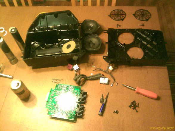

The box pry's open quite easily and with 4 more T10 torx, the amp board comes out.

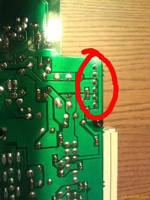

For me, this was the culprit.
The soldered terminals had broken loose as the plug is not well supported.
I re-soldered the 6 terminals and put it back together and all is well

Yeah, it was working intermittently and would go very crackly before going out, this was pointing me to the speaker connections more than the amp circuit.
