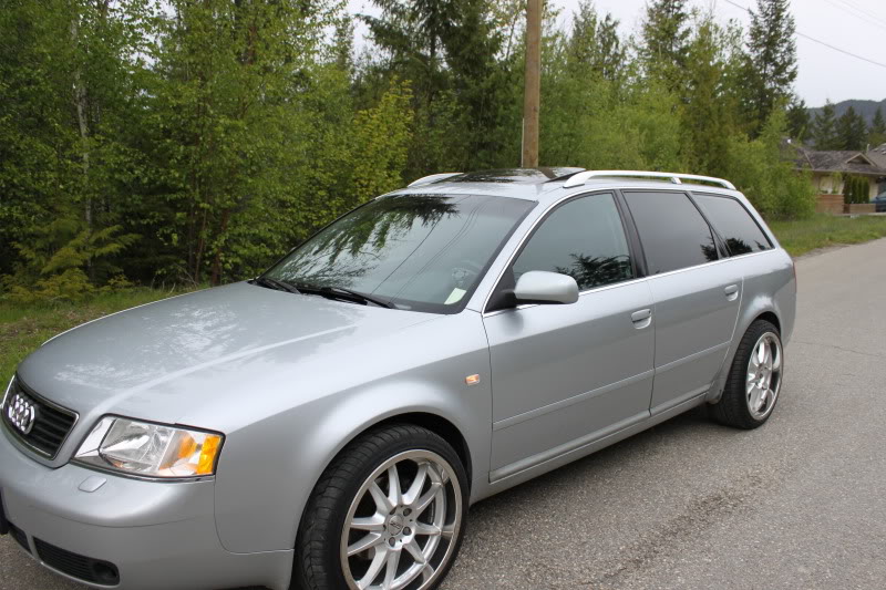

https://www.audiforums.com/forum/aud...wheels-179009/
That is hxgaser's Avant on 18s with stock suspension. I'm not sure what profile tires he's running but if I were to take a guess, I'd say a 40-45 series(?).
So with 19s and an even smaller sidewall (I assume it's gonna have to be a 35 series or less tire):

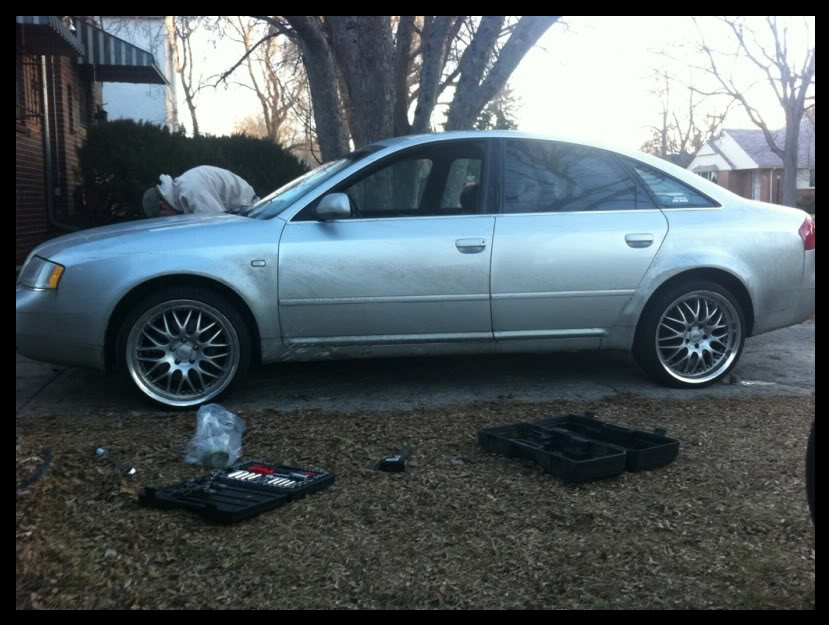

This sedan looks a bit crazy. I don't know if it's just a bad angle, the sidewall being too small or what.
These are 19x10, that's why they're poking out so much. I don't know the tire size.. but them things are meaty!
