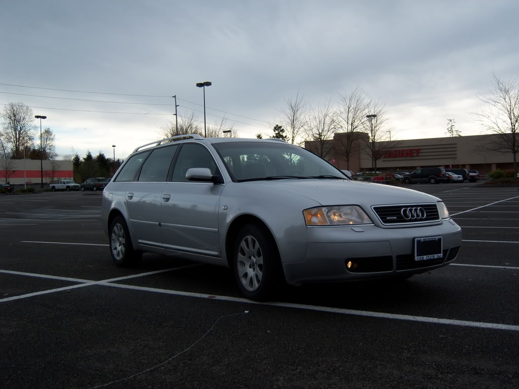

My other question is about the rear tails on my wagon. Does anyone know of a source for tinted or aftermarket ones? I simply want them to closer resemble the center light section in the rear.

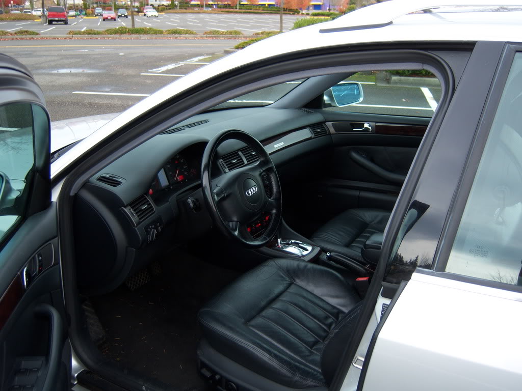

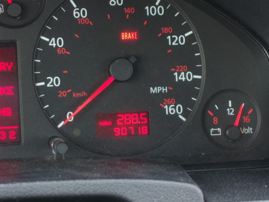

Here are a few pictures!
