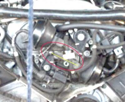

My indy repairman informed me the plastic post connecting a butterfly valve (in one of the variable induction control valves) is broken and needs replacing..he also said the dealer would only sell an entire valve (about $200).
Is there a way to get just the plastic piece/arm?
Do I need to get one of the 2 valves?
Do I have to go to a junkyard?
Am I out of luck?
He printed out a drawing from AllData (piece #A24-0246). From that I found/edited a nice photo from the net which shows the piece (see attached--it's a bit blurry, sorry--red circle is around the piece and the yellow line runs along the actual piece)
PS: big thanks to Bryan/C5 Tech for his writeup which included the original photo!
https://docs.google.com/View?id=df38f427_19hphbssq4
Thanks for any help!
Attached Thumbnails C5 2000 A6 4.2L -- Help needed-audi.a6.4.2l.intake.manifold.jpg

Do you need the straight arm from the vacuum motor to the butterfly valve arm OR the butterfly valve arm that the staright arm connects to? If the straight arm, a couple of rod ends from Pegasus and some threaded rod should do the trick (and look cool to boot!). If the butterfly valve arm, I would try glueing (yes, glue, as in Epoxy or Gorilla) the old part back together (assuming you have the pieces) then reinforcing the repair with some thin sheet metal over the end (like and end cap) glued and perhaps screwed onto the arm. You should do this yourself to relieve the mechanic of responsibility, which he isn't going to want to take.

I believe I need the rod from the butterfly to the vacuum motor..
From what I've found, it should be called the Intake Manifold Linkage Arm (gruvenparts.com sells billet pair for $80+)..but there are variations on that name.
