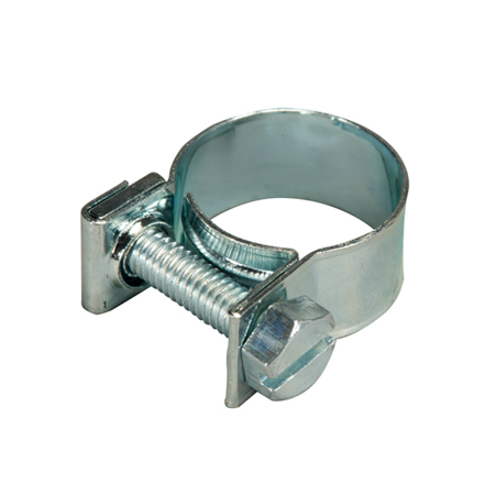

Or instead of the worm gear clamps use fuel injection clamps available at most parts stores. They seal better as they are made to hold at higher pressure and damage the hose less.
The pump will go long before you can damage the rack as even if the pump blows there will still be some fluid down there to lube the rack. The fluid pressure is used to assist your direction but lack of pressure doesn't do any harm to the rack as long as some fluid is present as a basic lubricant.

Attached Thumbnails C5 Power Steering Whine When Hot-fuel-injection-clamps.jpg

Not sure they make those clamps in that size? Yes i agree for the 8mm hose but i believe the suction hose is a bit larger. Not to mention it is a major pita getting that hose off the pump.

Well Thanks for the advice so far, I'll go through all the clamps this weekend. Im not driving it the mean time. And yes there is a major leak somewhere bc is practacally just draining all the fluid out in no time. I was looking under the car a little and noticed it looked like it was leaking by the firewall on the drivers side which worried me that the rack seal failed on that side. And I have a pump on the way so ill put that on right away. I would prefer to use the injection clamps if possible, I was reading around and some say the worm gear clamps cant get tight enough for the powere steering system of an audi.
