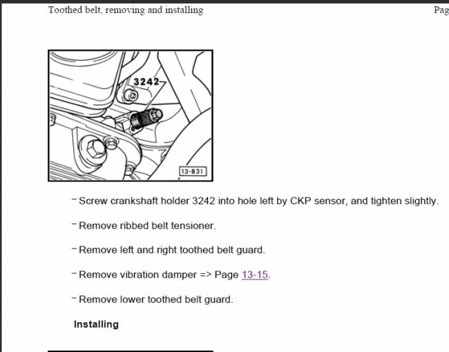

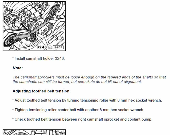

From what I see in the pics and read in the text(s), the 3243 locks the shafts in a position where is attached right on top of the sprockets' (what appears to me as a) big fastening bolt. The instructions say to attach the 3243 before realeasing the sprockets with the gear puller, in order to allow the belt to come loose. Since the sprockets can be released independently of the shaft itself, that makes sense. However...
Here is where I got some understanding problems:
- A previous step involves removing the pulley/vibration damper. Isn't that suppose to release already the tension and allow the belt to slide over? Or the damper isn't what would we call a "major player" in tensioning/tightening the belt?
- The instructions say to loosen those big bolts (24 mm is pretty big) about two turns - which allows you to actually pull the sprockets. Then remove the holding bar. Then pull the sprockets - with a "bang", the instructions mention.
a) Are the holes on the locking bar actually exposing those mentioned big bolts?
b) If the bolts are loosened the two turns and the holding bar removed at this point, how come the cams don't get out of whack when pulling the sprockets out with the "bang"?

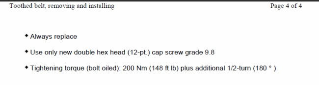

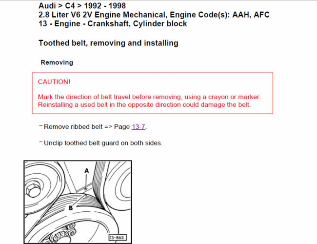

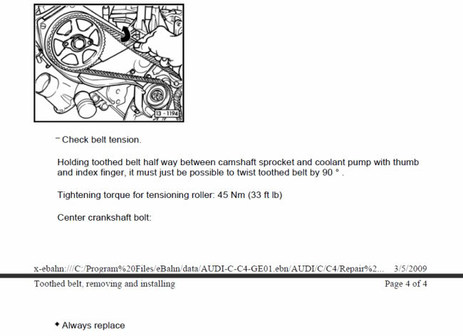

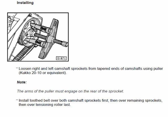

As far as the steps in the bentley manual, I will just attach a pdf-ed copy of the pages covering the removal and install... the steps are easy to understand up to "Remove lower toothed belt guard" on page 2.
After that they jump into "installing" , where after a pic and instructions of loosening the sprockets the next step is installing the holding tool.
While I understand the "installing" is the opposite of removal, they didn't even complete a removal step-by-step process...

Once you open up the car you will see this clearly, but I will try to describe it as much as possible.
Cam sprocket, or cam gear as I called it, in sense is held tight to the cam shaft with friction. End of the cam shaft is slightly tapered and once the 24mm bolt is tightened, it seats the sprockets. Anyways, between the bolt and the sprocket is a metal plate where the lockbar pins into. The plate is connected to the cam with a notch and there is only one way for the plate to go into.
So how the tensioning of the timing belt works is this. You loosen the 24 mm bolts to provide a little slack on the plates where the lockbar pins into. This provide a little bit of gap and allows you to pull the cam sprockets loose. Cams are still stationary, but the sprockets are now free to turn. Once you replace the belt, you can now tension the belt and the tension on the belt is uniform across the whole belt, because the sprockets are free to spin. If you don't loosen the sprockets, because the timing belt is toothed, only place where there is proper tension is between the bank 1 sprocket and the tensioner itself. Meaning through out the other parts of the belt, there is no tension. So once the motor starts and the tension equlizes through out, you have a chance of cams spinning out of sequence with the crank.
Hope this makes a bit of sense. Anyways once you open up the car, you will see what I am talking about.

Thanks man. I truly appreciate it.
Yes, it does make sense now. So basically by loosening the bolt you achieve a couple of things: a) you provide that little slack needed for the gears to come loose (the gear puller's toothed or screwing rod rests/presses on/against the bolt for leverage), and b) provides also the slack needed to slide the holding tool onto the plates.
If I were to make an analogy, I would say that the gear(sprocket) is more like a bearing that although rotates on the shaft and with the shaft together when in place or tightened, yet once loosened it rotates freely without moving the shaft anymore. Is that a fair assessment?
Anyway, from the ebahn pics to be honest I couldn't understand how exactly you loosen the gear without moving the (cam)shaft.

Your analogy is correct. Once the sprocket is freed, it rotate freely without moving the cam.
Only thing that is irrevalant is the point about the space needed to slide the holding tool/lock bar. You actually don't need any space because there is a large hole on the lock bar where the 24mm bolt head is exposed at all times. So you can just put on the lock bar.
