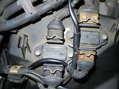

Hi all,
My 2001 A6 2.7T was misfiring on cylinder #2. Eventually, I switched the two ignition control modules on the filter, and the misfires moved to cylinder #5. Yay, problem localized, and it's easy to get at.
But ... I can seem to find a new or used one anywhere. I don't want to change both and I don't want to have to replace all the coils or anything. I just want 1 new ICM.
The part is Audi's part number 4A0 905 351A, or Bosch 0227100209. I live in California, north of LA.
Anyone know where to get one of these??
WItC

Call a dealership and give them the part number. They should be able to order one. Also, you could grab one at a pick and pull. Have you tried googling those numbers?

There are 6 of these listed on ebay right now under the 4AO part number both new and used.

Any local parts store, if they know what to call them. That's where I got mine.
