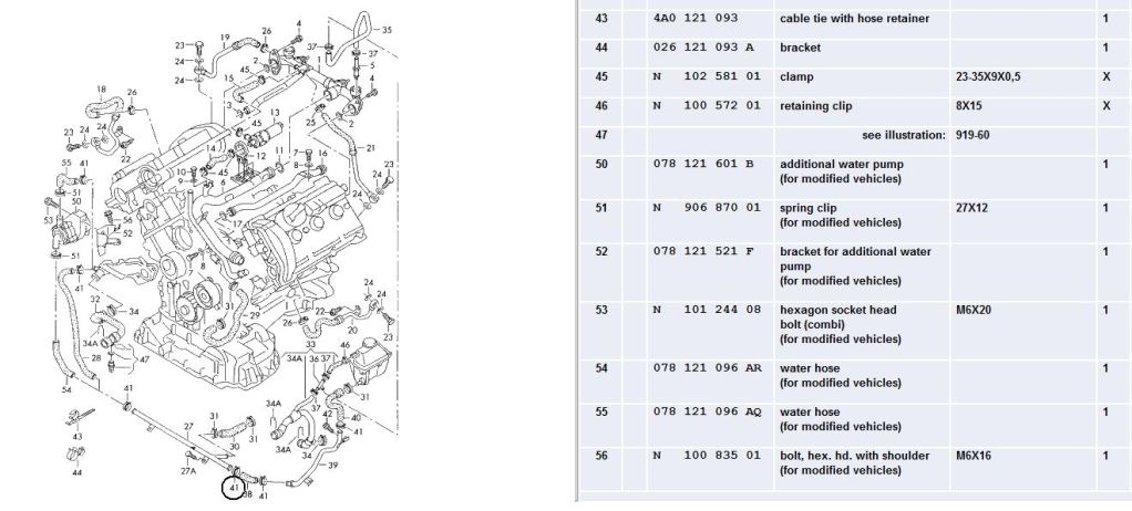

Old Nov 25, 2013 | 11:19 AM
Jeff-AudiUSAParts's Avatar
Former Sponsor
Joined: Apr 2011
Posts: 511
From: Beaverton Oregon
Here is a picture of your cooling system. 13 is the aux water pump, and that hose 14 would be suspect of a leak as well. The pump 13 is 145.08 and in stock. But Audi makes a relocation kit 078-998-998 for 187.75 and it's location is represented by #50 although the pump doesn't look exactly like that. It moves it down to that lower passenger side area in front of the block. You'd need 2 intake gaskets also at 8.37 each and a gallon of coolant, Audi brand is 18.10 but you may have some of that available to you locally. What this kit does is replace the 13 water pump with a plastic elbow, would be a good idea to get replacement hoses in that area too since the manifold will be off anyway. A harness is included so the new pump mounted farther away has the electrical power supply connection to it.
