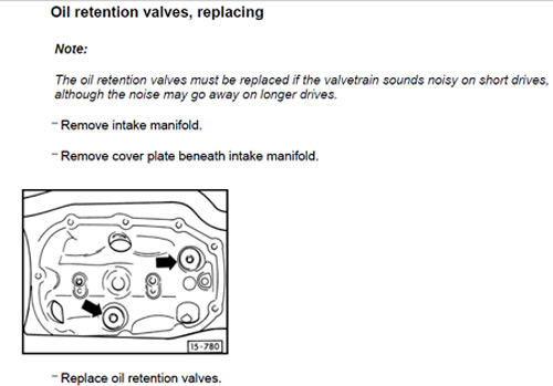

here's something:

Ok, I wish they would make up their minds as to how they call these damn valves.
Found them in the EBahn... aside from that TSB.
Now if I could only find'em somewhere....
Thanks again HX
