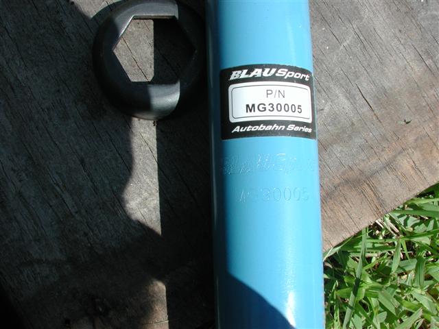

This kit comes with all the normal hardware you need to change with the struts including new bolts and nuts. Obviously each kit is different depanding on which model and year of car you have. In my case, the kit included the following:
    All in nice, Blue, BlauSport boxes. Ok, so far so good. I started to look at the instructions that came with the kit and found some very crappy generic ones in 4 different languages. Oh well, they didnt say there would be any. However, looking through these, I found a reference to KYB and Gas-A-Just. Hmm, it seems KYB made these as surmised. Ok. Looking at the struts themselves, however, did reveal that these are not simply 're-painted' as there is a 'BlauSport' and part number engraved into each one, and only the single, Blue, paint layer. Again, all ok.

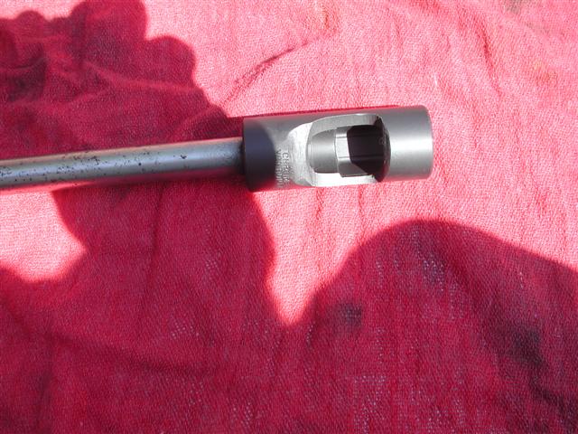

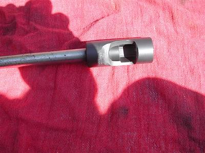

    As I didnt have the special Audi tool for removing the strut nut, I went to my local Smith's Farm Store and found both a 22mm Deep Impact Socket and 7mm Long Arm Allen. Using my bench grinder, I proceeded to make my own:
    DIY: BlauSport Struts-dscn4293-small-.jpg

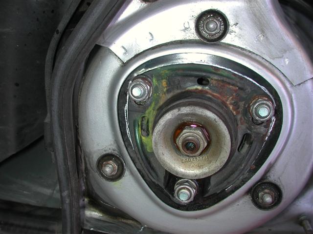

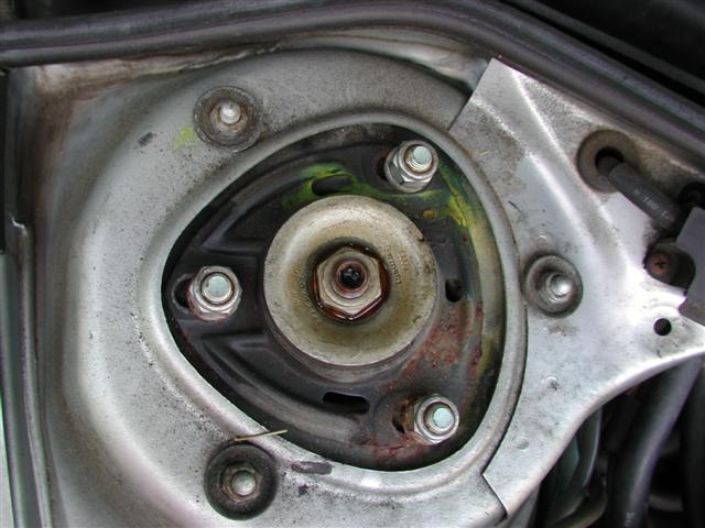

    Heading to the car, I first looked at what I was dealing with. It wasn't good:
    DIY: BlauSport Struts-dscn4289-small-.jpg
    DIY: BlauSport Struts-dscn4290-small-.jpg
    First thing I did was hit the nuts with PB Blaster, wipe off the crud, and mark the Upper Mounts so I could get the Camber back to close:

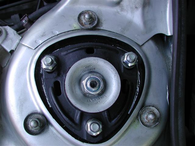

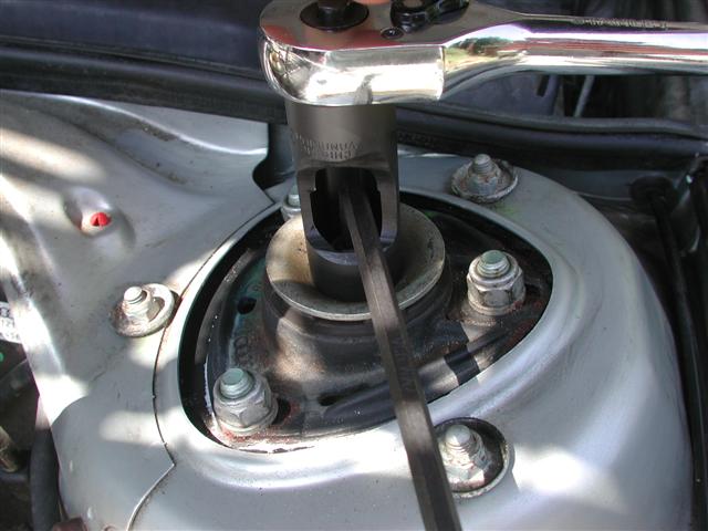

    Next, using the homemade socket tool and allen, I removed the Upper Strut Nut:
    DIY: BlauSport Struts-dscn4294-small-.jpg

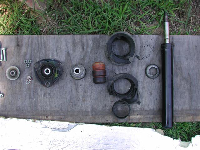

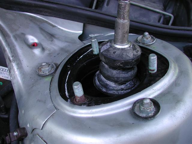

    Next, I removed the Upper Strut Mount, then put the Upper Strut Washer back on with the Strut Nut and used that to hold onto while giving the strut a sharp pull straight up. It came out after 3 good pulls. This was what I had taken out, in order of disassembly.:
    DIY: BlauSport Struts-dscn4310-small-.jpg

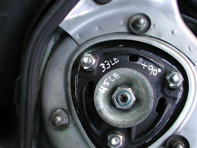

    I like to mark frequently loosened nuts and bolts with their torque specs for those techs who never look them up:

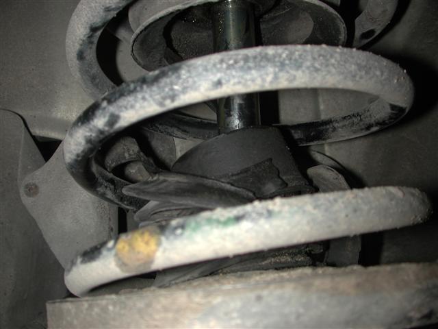

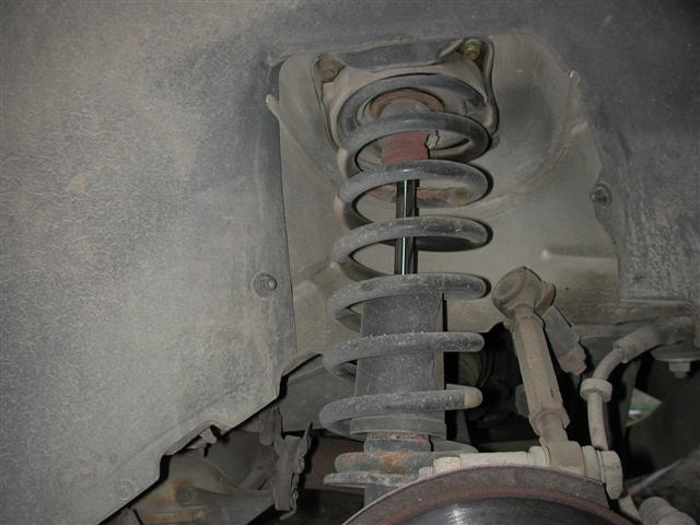

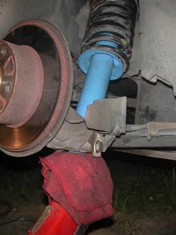

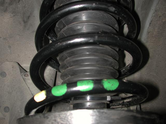

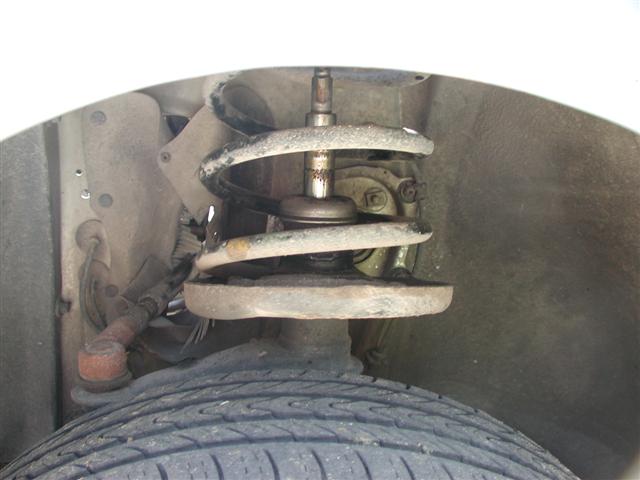

    I removed the tire and jacked the car up to get a look. Here's what I found. Notice the Dust Boot and Bump Stop are separated with the Stop looking rather raggy:
    DIY: BlauSport Struts-dscn4312-small-.jpg

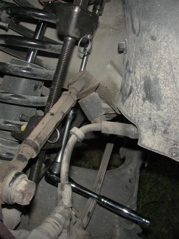

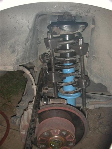

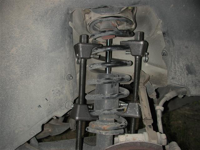

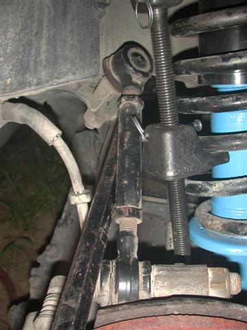

    I have found that when doing these types of struts, its easier to use the Strut Compressors to relieve the tension on the bottom bolt and to prevent the Strut from 'springing' down and out, potentially hurting you or causing damage. Its tight, but can be done. NOTE: watch the CV Boot while working! It is real close and if you damage it, your screwed.:
    DIY: BlauSport Struts-dscn4313-small-.jpg
    Using a set of extensions, I unscrewed the three Upper Strut Mount nuts, then the Lower Strut Mount bolt. If you've got the tension right on the compressors, it should slip right out. If not, use a drift or punch to tap it out. Then just lower the whole assembly:

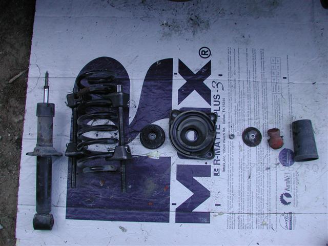

    Set it on something flat and solid and disassemble. Since these are not being reused, I used a pair of pliers on the Strut Rod and an impact on the nut. Here's the parts in order on disassembly. Notice, again, the compressed Strut - another very bad strut:
    DIY: BlauSport Struts-dscn4315-small-.jpg

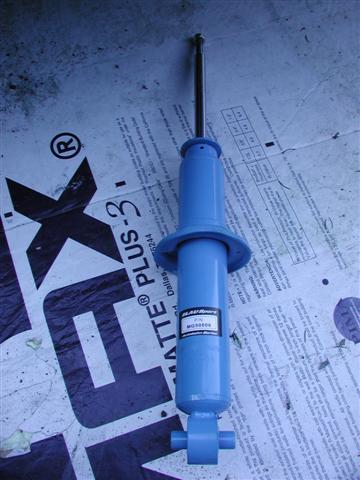

    Heres the replacement with integrated spring seat:
    DIY: BlauSport Struts-dscn4317-small-.jpg

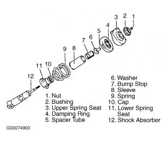

    Placed Bump Stop w/ Boot over the Strut Rod, then the Upper Bearing Washer, Coil, Upper Isolator and Upper Mount Plate, the Bearing Spacer, Upper Bushing and Rod Nut:

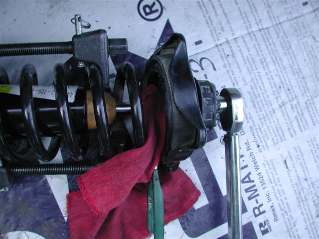

    To tighten, you can either use the special Audi tool, or do what is usually done - using pliers and a rag . I used a pair of pliers and a doubled up rag to hold the Strut Rod while tighten the Rod Nut. If you go this route, remember to only hold the very top of the rod. If you nick the rod where it inters the Strut, you will quickly ruin the seal and thus the Strut. The correct spec is 22ftlbs. NOTE: My pic shows a torque wrench, but I actually used an impact set to a low setting. With a moderate pressure being applied to the pliers, the rod will spin in the rag when tight enough and not strip the Rod or Nut. It takes alittle experience to do correctly:
