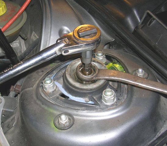

As I didnt have the special Audi tool for removing the strut nut, I went to my local Smith's Farm Store and found both a 22mm Deep Impact Socket and 7mm Long Arm Allen. Using my bench grinder, I proceeded to make my own:
Attachment 4769
(continued)
Attachment 4769
(continued)
As far as the tool needed; for those of us without a bench grinder...try using an "offset, oxygen sensor socket". I tried this out last night and it seems to work perfectly for this application.
If I have any issues when I actually change the fronts out (my mission today), I will let everyone know.

For removing the strut nut, I can add another "tool" version, as I couldn't find my ox sensor wrench. I attached a pic.
As far as the job itself, man I really have hard time getting the Threaded Cap removed, and I wish I should have double-checked Jim's write-up before starting the job. I remembered about the pipe wrench, but I only have a huge 36"-er and it doesn't really grip the cap right. I tried with a pair of big channel locks and still no go. It looks like I need to get a diff pipe wrench or use some heat... Also, needless to say, I already removed the mount (like an idiot) and my strut decompressed under its own weight, just like Jim's...

You'll need the proper socket when its time to tighten that nut as you need to make sure its at the proper spec.
