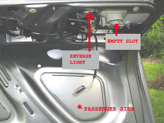

Is this "Neutral Safety Switch" responsible for activating the backing lights when shifting into reverse?

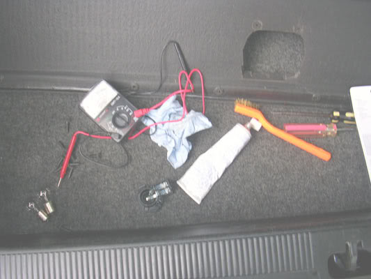

I just noticed last night that I don't have reverse lights at all. Today I checked them out and still no resolution.
The bulbs are fine, and I have power coming to both connectors. That certainly eliminates a short and/or a blown fuse.

yes, indeed, although I should have said "power plugs".
I had my wife helping me (shift it to reverse) while I checked them, and got power on both sides as it should be.

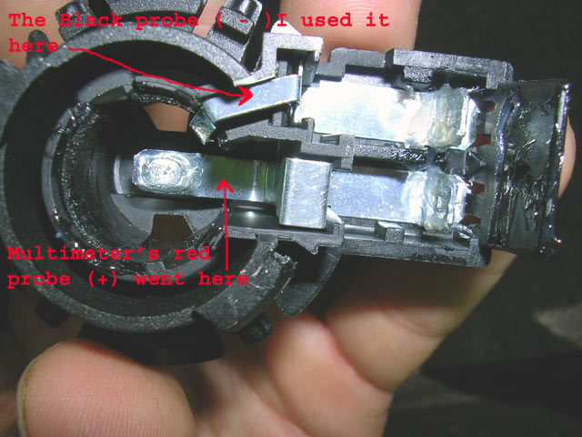

Well, for what is worth, I noticed that the power plug on the driver side has three wires connected, as compared to only two on the passenger side.
I would assume one is "hot", one "ground", and the third one comes from the switch itself - red-and-white one in the first pic?
If the switch is bad, then it would not send an electric impulse to rely the fact that the gear is engaged (while the plug itself still gets power), would it?
Also, I did do check the voltage by connecting the probes to both "prongs" of the power plug. I also cheched again at the socket after reconnecting it. I haven't used a different grounding. Is that what you meant?
