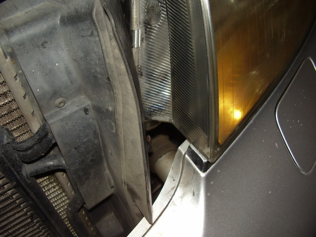

Old Jul 9, 2010 | 05:48 AM
Thedemon's Avatar
Joined: Jun 2010
Posts: 13

From the pics you are trying to remove the clips that hold the unit together, don't do this. Remove the engine compartment trim panels along the front fenders and the fresh air duct that hide the rear of the headlight units, the clips I mean are on the REAR of the headlamp units.
