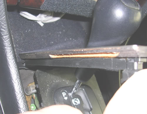

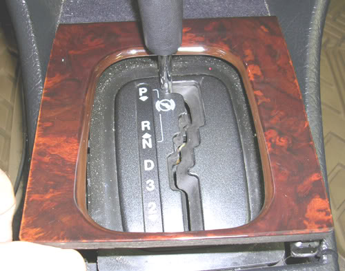

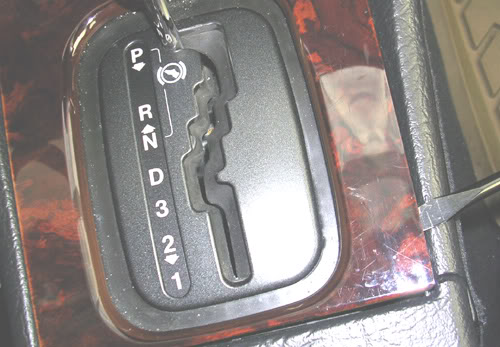

1) Step one is to remove the wood trim piece around the gear selector. A flathead screwdriver does the job very well. Insert the head on either side, toward the front of the cover - the end facing the seats. The plate has cut out areas on both sides. Pry up gently, but be careful not to scratch the wood finish. Mine looks scratched anyway from the previous owner, but it came out without a hitch.

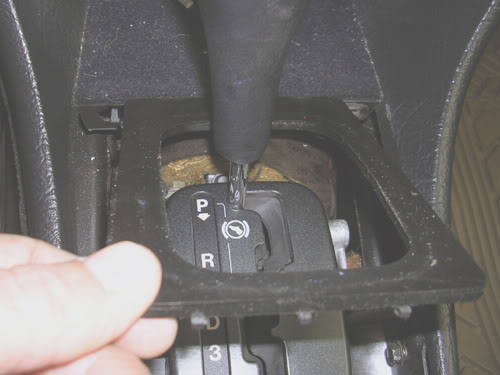

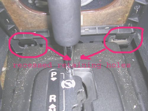

2) You should be able to easily pop up the cover plate (it is held in place by 2 holding rubber tabs that snap in two retaining plastic clips placed on the bottom of the "bay" area.)
3) On the "back" end (toward the dashboard), the plate rests in two slots (lined with rubber retaining inserts) via two plastic tabs. So pry gently the cover toward you and up, as you'd try to flip it over the shift ****. The plate should come out easily now.
4) Under the cover plate there's a "free floating" rubber lining piece that you just pull out.

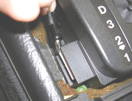

5) The light unit rests on the left area (toward the driver), adjacent to the gears display. The bulb harness comes easily out, as you don't have any retaining clips to pop.
6) The bulb comes out after some firm wiggling. Be firm but gentle with your grip, as the bulb may break while still in the socket
7) Replace the bulb with a new one and slide back the harness.
