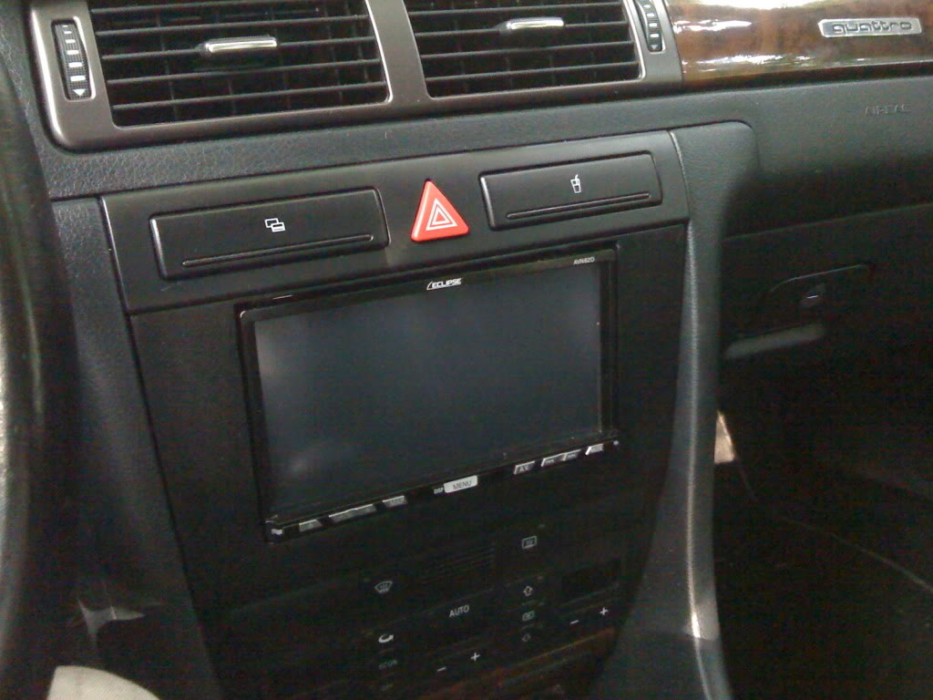

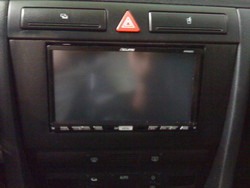

So I ordered a dash kit for my a6 last week and when it got here I shocked at how huge the opening was compared to my head unit. MY Eclipse has a protruding face which is slightly smaller the the body of the HU. The dash kit opening was slightly larger than the body of the HU... soooo..... if I wanted the face flush with the dash, I ended up with a 1/2" gap all the way around. [headbang]
Solution? I cut out and fit some 1/4" ply to my desired gapping (after using all my power to get the unit deep enough in the dash ). Then I bondo'd that bad boy in, sanded and painted for the outcome below!!
Who says nothing looks better than stock?!

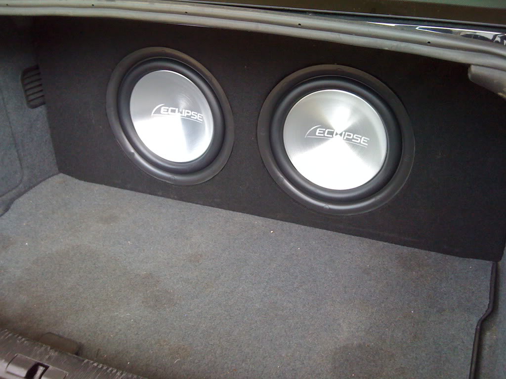

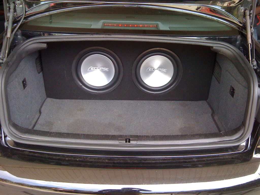

Here are my subs:
