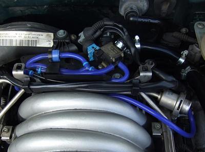

wondering if when i replaced the vac lines, I put the vac line from the fuel pressure regulator back on wrongly - at the mo it goes straight to the EGR Vacuum Solenoid Valve via a t-piece. Should the vac-line from the fuel pressure regulator go via the non-return check valve, then onto the vacuum solenoid? Can anyone quickly check theirs...?

So, as above just require some confirmation on the vacuum lines on my Audi A6 2.8 30v.
Should the vac-line from the fuel pressure regulator go via the non-return check valve (part # 433 862 117) blue/black valve, then onto the vacuum solenoid? ..wondering if when i replaced the vac lines, I put the vac line from the fuel pressure regulator back on wrongly - at the mo it goes straight to the EGR Vacuum Solenoid Valve (part # 026 906 283 H) via a t-piece - gold colour solenoid in pic.
After doing the vac lines it is idling very badly / engine popping / misfiring... - without putting your foot on the gas, it cuts out.
No engine errors codes reported in vagcom, which seems a little strange.. Could someone quickly please check their vac lines for me.. many thanks
Audi EGR Vacuum Solenoid Valve - 026 906 283 H (gold colour solenoid)
Audi Non-Return Vacuum Check valve - 433 862 117 (blue/black check valve)

FYI, there should be a vacuum diagram sticker under the hood.

thanks guys for the replys - finally sorted out the issue with the rough idling / mis-firing etc.
I had taken off the throttle-body for a good clean, and failed to screw it back on properly with the gasket - doh!
I sprayed some intake cleaner around the engine to see if they were any vacuum leaks, and there was a significant leak around the throttle body!
Many thanks for all the tips, but just a heads up -
If you ever encounter any rough idling, mis-firing etc please first check your vac pipes (replace with silicone, very cheap) and then clean and 'carefully' put back your throttle-body and do a TBA.
