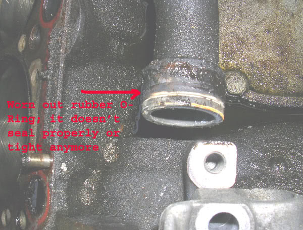

Old May 24, 2009 | 11:06 PM
chefro's Avatar
Joined: Dec 2008
Posts: 1,941
From: IL
Here's a closer pic...mind not the comments...lol
You can see the pooled liquid over there, but mine was coolant mixed with oil.

I know I went overboard with the pics, but hopefully it illustrates better what I was talking about:
Truth be told, I hope this isn't your problem because you'll have to take the manifold out in order to replace that o-ring.
If unfortunately it is, make sure you order also the "Main Rear Pipe to Cylinder Heads O-rings".
You may not need them, but you'll have to remove the pipe from the heads anyway
