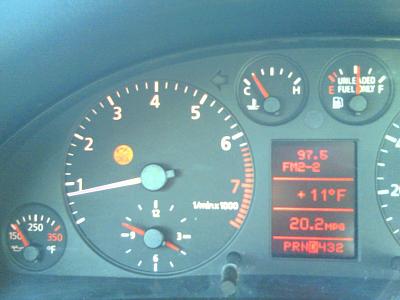

Well this is what I got after about a 35min drive: the oil coolant level is at around 1/8(200deg) and the motor coolant level is at around 1/4(see pic). What should the oil temp be at?
I think that the vacuum lines are prob suspect due to their being very brittle and as i said before they look like they had been chewed on a little in the past by mice. You said all the hoses could be replaced for around $5? That sounds great!...how long of a job would that be?
Thanks! https://www.audiforums.com/forum/att...1&d=1233859200
Attached Thumbnails Help! Coolant Temp and Oil Temp, Gauges Low!!!-new-gauges.jpg

This is the same pic as in the original post.
Did you actually take that pic after driving for at least 30 min, and before hx suggested you do so?
It is still 3:48(h) and 11° outdoors...

The temp gauge should be halfway up after no more than 10 minutes of driving, no matter how cold is outside. Looks like a stuck thermostat. Has the TB been done?
