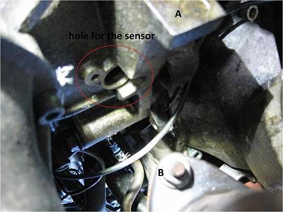

I found and bought an old engine with $550. It is from a 97 A4 Quattro Sedan. Then my mechanic put it into my wagon. Everything looks corrct excpet that the crankshaft position sensor does not fit. The picture below shows the sensor from my wagon. The mechanic said it is too long and it will hit the wheel.

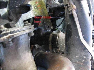

I attach two pics there to show the location of the sensor. Could anyone help me to identify what sensor it is? I appreciate your help!

Did the mechanic try it and confirm that it hits? This sensor has been used in all of the 2.8 V6 engines for many years.
The clearance between the end of the sensor and the crankshaft counterweight is only about 1mm. I would have one person hold it in by hand and another turn the crankshaft slowly. The person holding in the sensor will feel if it hits.
