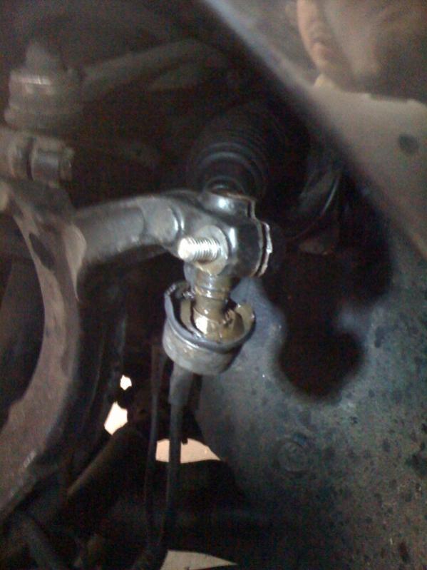

I am trying to replace a bearing joing that connects the steering wheel to the control arm
I was only able to take half of the screwing part off and i cant get the whole thing off. THere is a screw and I dont know if I need to take it off or just leave it there
do I need any special tools to remove this piece? do I need to take out the screw??
please help, I need to fix this urgent

If I understand your question, you need to remove the screw before you can remove the tie rod end from the spindle. The vertical shaft of the tie rod end is scalloped out and the screw retains it. I put the nut back on until it was flush with the end of the screw and then used a small sledge hammer to break it loose. At that point you can use a punch to drive it the rest of the way out. Once the screw is out, you can use a ball joint separator, a pickle fork, or a hammer to remove the tie rod end from the spindle. I hope that helps. Good luck!

For future reference that piece is called the outer tie rod end. Their replacement is a regular thing on most if not all cars.
99a6 gave good advice on getting out it. +1 . Good luck

thankyou, I have tried doing that but the screw or the rod wont give and they are stuck on there really tight. I couldnt remove it, so I called a friend who is studying to become a mechanic, hopefully he can get it out easily

Everything about control arms and tie rods is tight because they all rust into place. Your replacing the piece so dont be afraid to get rough with it. Its also a good idea to replace the TRE pinch bolt with the TRE

Thanks, my friend( the mechanic) and I ended up doing just that. We banged the hell out of the screw that pinches the tie rod and we had to replace it aand it was not easy to find one. Also we needed to use a grinder because the tie rod was so tight we needed to cut it in half and then grind it doing for a socket. It was horrible for having to be an easy job.
