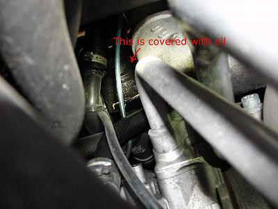

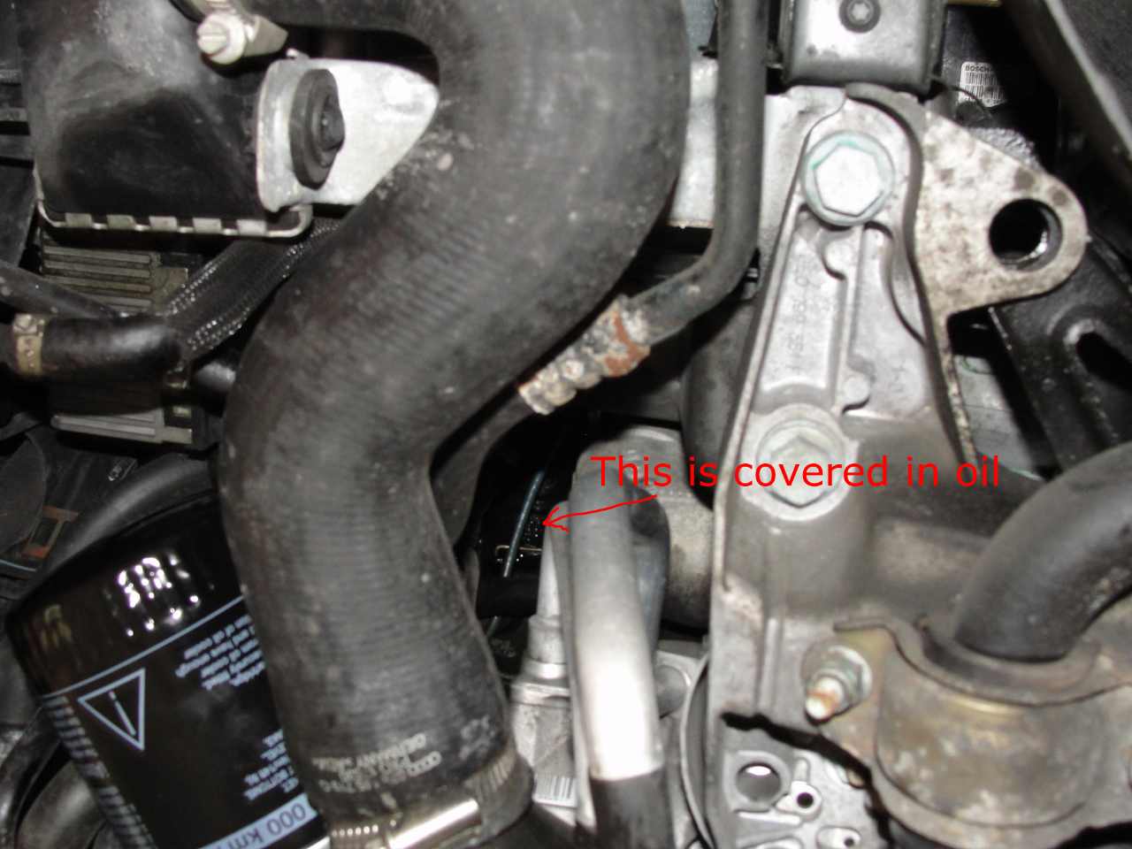

Today, after changing my oil, I looked up in the engine compartment and found an oil leak. I'm not sure what's leaking, but I snapped a couple of photos. There is a "zoomed in" photo and a "zoomed out" photo for a frame of reference. Can you please help me identify the problem? Thank you!
Also, I've had oil residue on the underside of my oil pan and noise reduction panel for the last 10,000 miles / 3 oil changes (including today). I've always figured it was leaking from the drain plug after finding a washer crushed to oblivion. Or perhaps I didn't tighten it enough (40NM).

Looks like it might be time for new cam chain tensioner seals.

Thank you very much.
Blauparts has a kit for this. Also, they have a page that has an image that shows spot on the same symptons. See Image 1, driver side, Audi Valve Cover Gasket Kit - Audi Cam Tensioner Gasket Replacement - Blauparts.
Couple more questions.
1) Is the Blauparts kit good?
2) What other repairs should be done with this? My car has 54k miles, 2004 2.7T S-Line.
I've been looking at some of the DIYs out there. It's a common problem with lots of input so I may be able to tackle this myself. Although, I'm waiting to hear back from my dealer's service advisor for a quote.

Thanks for the help guys. I ordered the enhanced kit from Blauparts and replaced the value cover only. For the following reasons.
1) When I took it apart I broke the tool (it was late and I wasn't at TDC). For others, before compressing the tensioner make sure you are at TDC by rotating the crankshaft clockwise as you are looking at the front of the car.
2) I found a lose screw on the front of the valve cover, ie no socket needed to remove. I believe this was the cause for the leak.
3) I examined the half moon seal by looking at the opening under the tensioner solenoid. It did not appear to be leaking.
4) I found oil on the back lower half of the timing belt cover. This appears to originate from the valley between the two cams covers. Probably caused by the loose screw.
5) No leaks at the back of the engine for cam sensor seal or cam cap so I didn't not replace these either.
Anyways, time will tell the true cause. I'll let you know if it continues to leak.
