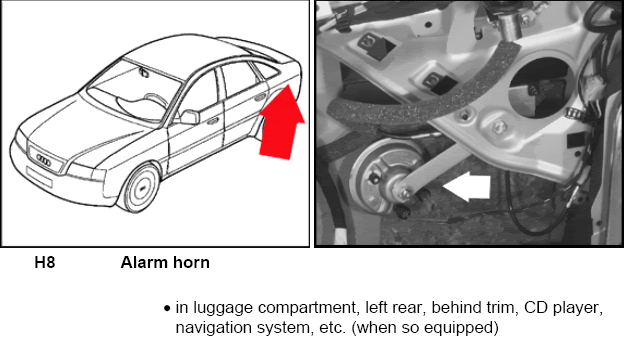

Finally. I am thinking about doing the same thing but can't find the stupid horn.
02 AVANT here. I know it is in the back somewhere behind the Bose Sub - just can't get to it.
Let me know if yours work.

I'm planning to change out the factory horns on my 2007 A4Q, and put in Hella louder horns - but where are the horns mounted ?

I've replaced my stock horn with an aftermarket 12v siren with success. In my 1998 a6, the stock horn is on the drivers side in the trunk. There should be only two wires connected to it. Brown which is ground and the other (red) which is +12v when the alarm is armed, disarmed, triggered or panic fired. I mounted my siren underneath the car, (inner fender well) and it has worked great under there for a few years without any problems. And yes it is damm loud to the point where it is annoying when it is going off. Any 12v aftermarket siren will work, but I suggest something small so it is easier to mount under the car.
so there is your location... I am gonnado the upgrade this week. Anyone have any suggestions on the horn?
