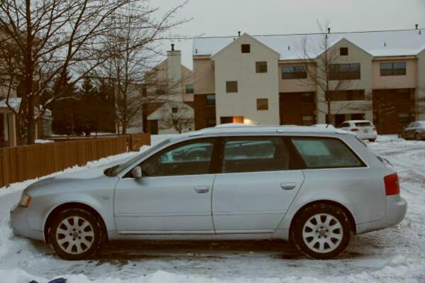

After driving it around I noticed a knocking out of the front suspension I didn't notice before, maybe strut mount, hard to say. I can only get it on large bumps. I wil tackle it summer unless it becomes a problem. Hopefully I can get a couple of warm days so I can pull the timing belt.

nice, same colour as mine, albeit better condition paint for yours
if you hear a knock it could just be the endlinks, those are cheap to order on ebay. i got a pair for 50 shipped out of ontario canada and they are fine quality
but a piece of advice, get a tranny flush pronto
edited: referencing lower endlinks
