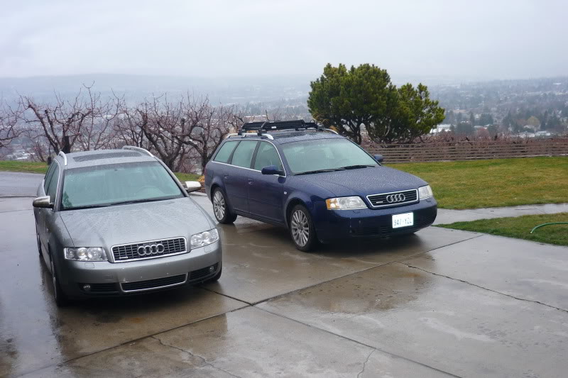

it's the blue one...help save it!

I'm not even sure I understand you? What the? I'm not buying the car, I already own it...I've owned the car for a couple months, and while it was a decent deal I've been chasing this problem since the 1st day. I also own the other car i the pic.
