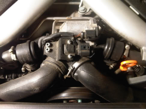

Changed my mind. Installed Bailey DV30's instead of R1's and a Samco TBB Friday and have an appointment with National Speed in Wilmington,NC to get my car chipped with GIAC software on Tuesday. Pics of DV's and TBB soon.
Before
After
Before
After

Looks good and I think you made good choices. Just go a little easy on the hard acceleration, esp at >3000 rpm, or you can jeapordize your tranny. I suspect the extra power contributed to the early demise of my clutch...that, and an (alleged) 150 mph run where it was bouncing/slipping at the very end.
