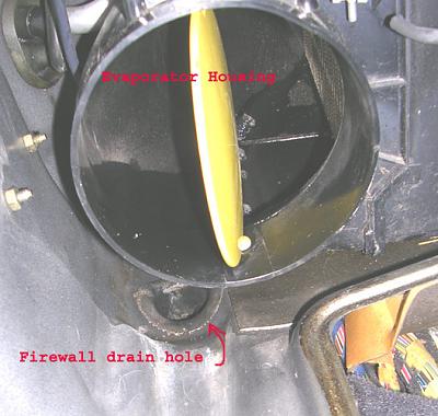

- Keep your plenum drain hole clean - it is located directly below the HVAC box

I spent a while vacuuming and blowing leaves and junk form the AC/Heat plenum area, and the upper trunk corners.

Ditto also on the plenum drain. This gets clogged and then you get water in the passenger foot well which is also the location of the engine computer. As you can guess, this can be bad news.

I did not see the plenum drains.

The plenum drain is under the hood between the firewall and the windshield. There is a plastic cover that you must remove. Under the cover you will see all of he HVAC stuff. If I remember correctly the plenum drain is at the bottom of this are in front of the passenger seat (assuming a left hand drive car). That area gets filled with leaves and other debris.

The plenum drain hole (my car only has one) is directly below the passage duct between the evaporator housing and HVAC box (see the insert)

I think I see the drain under the plenum, I'll get some air and water and verify its clear this weekend.
