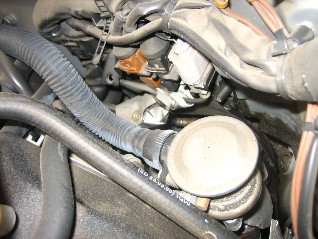

Hey, that is the sensor! Right?
I hope you can see what im talking about, but how in the world are you able to put a new one in the hole it you cant reach down there, what tool or toold do you use?
