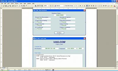

I am pulling CEL's P1131 & P0421: O2 Sensor before driver's side Cat - Internal Resistance too High, Warm Up Catalyst Bank 1 Efficiency Below Threshold - Intermittent, respectively.
I've recently replaced deteriorated rubber vacuum hosing and checked the corrugated PVC hosing for leaks without spotting any trouble areas. Replacing the hosing increased performance noticeably initially but car is again running a bit sluggish. I've attached photos of my work and the related VAG COM info.
Can I pass the "Readiness" tests and still need to replace the O2 Sensor and Cat?

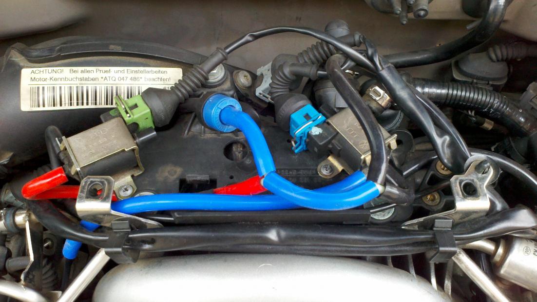

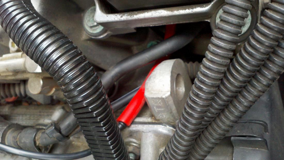

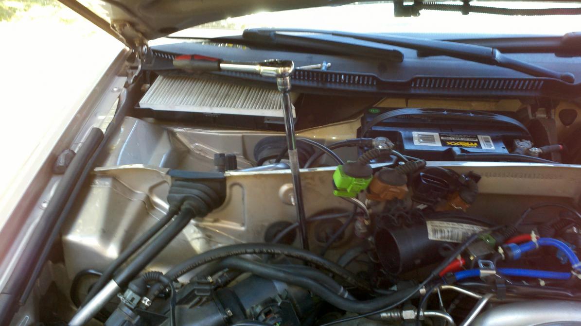

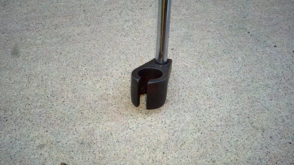

I attached a few photos of the Front 02 Sensor removal process and will provide a brief outline below.
Bank 1 - Sensor 1 - (Passenger's Side - Pre Cat)
1. Remove Intake hose after Mass Airflow Sensor.
2. Remove Vacuum Line attached to One Way Check Valve. This is a J shaped rubber attachment which runs a plastic hose to the Driver's side One Way Check Valve (looks like a bell one would attach to a bicycle) and Secondary Air Injection Solenoid. The O2 Sensor in question is located beneath and adjacent to the One Way Check Valve.
3. Remove the two bolts that hold in place the plastic housing to which the various sensor connectors are attached against the firewall (I think it's the firewall). Slide the plastic harness toward the center of the engine compartment carefully.
4. If necessary move the three hoses that run through a plastic router beneath the sensor harness' location prior to step 3.
5. Break out your sensor wrench attachment and slide the O2 Sensor cable through the attachment's slot.
6. Attach your wrench extensions to the attachment. I used a 24'' extension without much luck. I eventually added a 6 inch extension that gave me the angle and leverage I needed to move the sensor.
7. I ended up getting the sensor loose while the car was running. I tried heating the car and stopping the engine but could not get the bolt to budge. Torquing while running the engine was the only way I could pull it off.
8. Once the bolt comes loose let the car cool and remove the sensor by hand.
9. Remove the old sensor connection from the female ECU connection. I cut the old cable sensor cable to aid the removal of the sensor from the engine compartment.
10. Screw in your new sensor and connect the male attachment to the female ECU connection after finding a suitable routing scheme for your new sensor wires. Zip tie the excess cable appropriately.
11. Reattach and replace items removed for accessibility purposes.
Bank 2 Sensor 1 - Driver's Side - Pre Cat
1. Remove coolant expansion tank and carefully place out of harm's way.
2. Remove Vacuum Line attached to One Way Check Valve. This is a J shaped rubber attachment which runs a plastic hose to the Passenger's side One Way Check Valve and Secondary Air Injection Solenoid. The 02 Sensor in question is located beneath and adjacent to the One Way Check Valve.
3. Follow steps 5 through 11 listed in Bank 1 Sensor 1 removal outline.
I was extremely winded after removing the sensors. I ended up cutting the female ECU connection for Bank 1 Sensor 1 after correctly removing Bank 2 Sensor 1 and replacing. Be cautious before cutting wires if you are a putz like this hombre.

I attached the wrong photo in the post above. This is a shot of the engine compartment from the front with the wrench attached to Bank 1 Sensor 1 (Passenger Pre-Cat).
