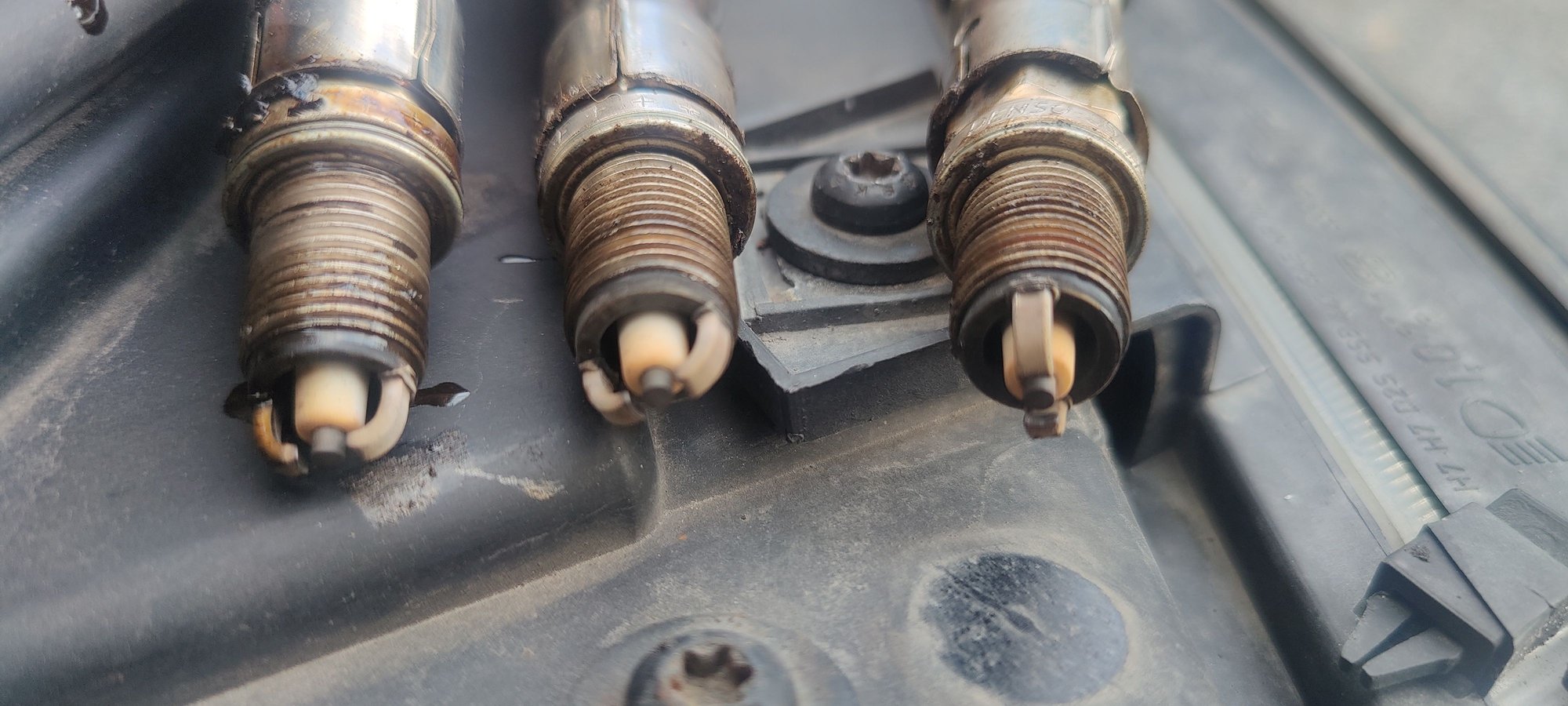

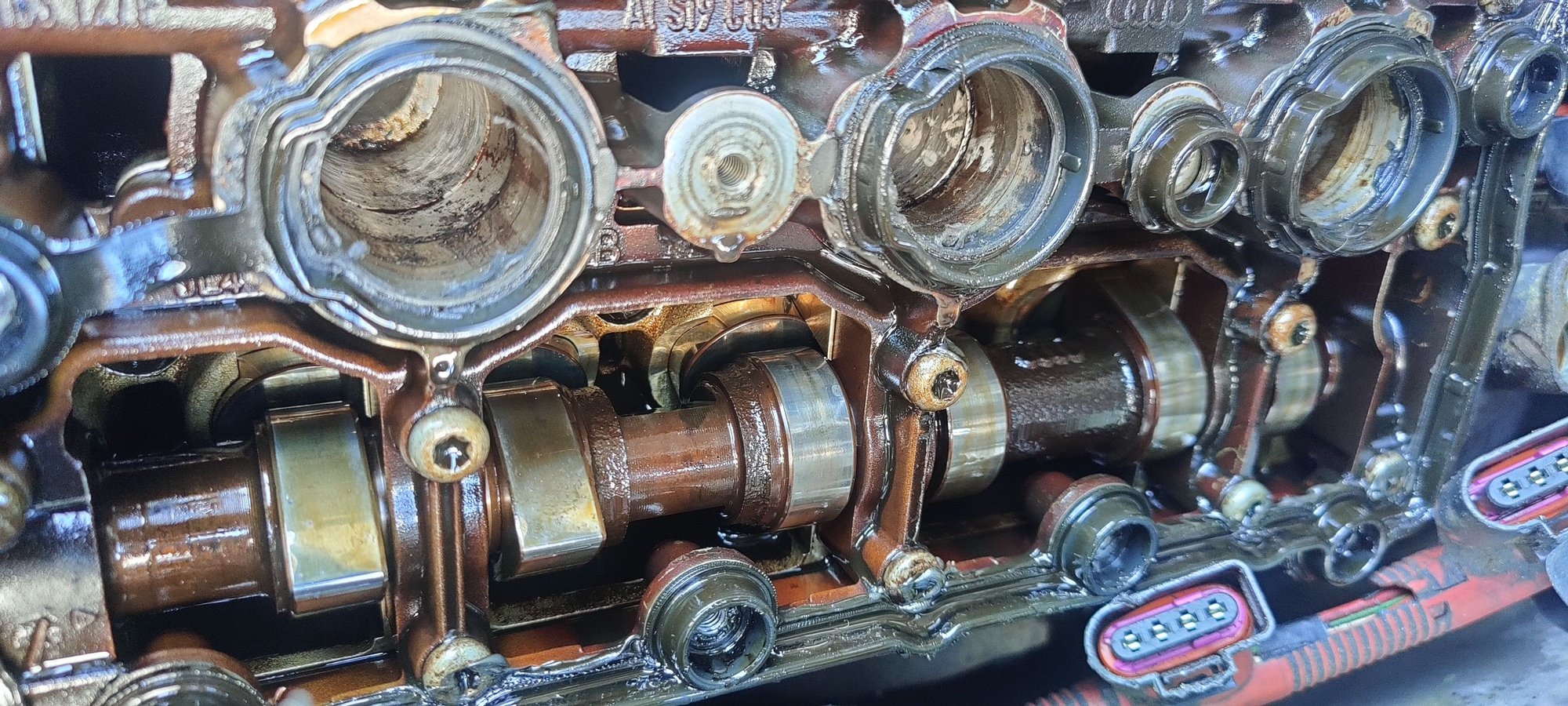

I own 2003 a6 with ASN engine.
Having trouble with p0300, p0306,p0305,p0304
So cylinder 4,5,6 are misfiring. cylinder 6 is ALOT more worse than other.
I've changed spark plugs, chaned coils. Tried even 1.8t engine coils. no effect. always same codes same cylinder.
I dissasembled the head and cams look perfectly fine. like brand new.
Car starts up fine and has power no issue. When rpm's closer to 2k, then engine fault light starts blinking.
I feel no misfire when driving.
When idle, I can feel the misfire.
What can I do what can I check? I attached few pictures from live data. maybe someone can help me?
