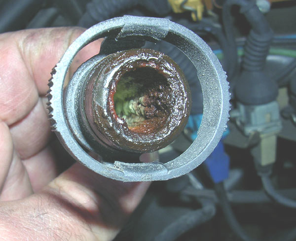

The snapping plastic clamps really scare me. It seems that they really don't seal the breather connections well at all. I was thinking of using hoses that overlap and use clamps on the outside of the relevant connections.
The plastic surely is less absorbent than any alternatives but the corrugation seems to promote the initial accumulation of build up. I absolutely could not believe the amount of gunk I discovered in these breather hoses the other day. Couldn't imagine any material could be any worse.
You can replace the plastic section with vacuum hoses. (I saw a forum post a long time ago, but forget where it was.) Only thing to consider is that the hose section depth will be bigger than the plastic, so it would be a bit fatter, but I like mine a bit plump than skinny and brittle
