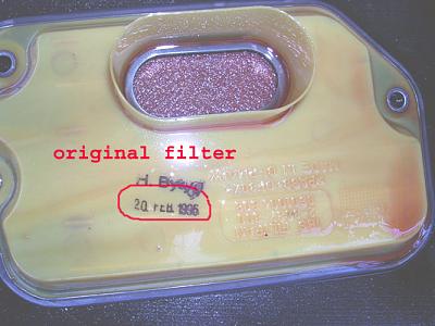

Attached Thumbnails PICTURE of my '07Audi A6 3.2 Quattro Auto trans fluid @ 48K-22-oldatf.jpg   PICTURE of my '07Audi A6 3.2 Quattro Auto trans fluid @ 48K-14-pan.jpg

Originally Posted by Midniteoyl
I think yours was changed at some time, chefro. The original was suposed to be amber colored.
I doubt it was done previously, as the filter was the original (had 1995 stamp on it). There's nothing about a tranny servicing in the maintenance records from the previous owner, who bought it brand new.
I have a stack of records, although some years are missing.
If it was done, then it was either done outside of a shop, or it was done without a filter change (less likely).
Attached Thumbnails PICTURE of my '07Audi A6 3.2 Quattro Auto trans fluid @ 48K-15-originalfilter.jpg
If its a ZF transmission, then the original lifeguard fluid should be light brown, or amber as the previous poster said.
