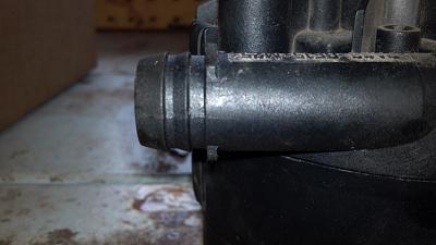

One other question that I had when placing the hose back onto the Secondary Air Pump was how far the hose should be put onto the pump's nozzle. As shown in the below linked picture (and attached) there are two ridges and then two taller nubs at the back of the nozzle. Is the hose supposed to fit all the way over the two nubs in the back or just the two little ridges before the nubs? I only put the hose around the two little ridges as I thought if it went over the two nubs in the back that it would leak around them (as there are gaps in the nubs around the nozzle).
Thanks

The hose should have a plastic pinch clip. The clip should click. Also the end of the hose should butt the plastic tab.

When you mentioned a plastic clip that clicks, are you referring to the clip on the end of each of the plastic tubes that go into the engine exhaust ports? Per the attached diagram, I am referring to the two tubes that branch to both export ports in part # 17. Thank you as well for confirming that the rubber T tube should butt up against the plastic tabs on the back of the air pump (as this is what I have done).

As for the clips, I was referring to a 2.8 set up, which has plastic clips attached to the hose. For 2.7, a hose clamp... Just push the hose until the end butts the tabs.
